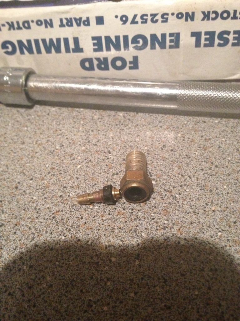

Made a start on fitting new seals and stainless bolts to my carbs tonight and well Erm this kind of happened...
It's part of the carb heater set up, will it run ok with out it fitted or am I going to have to splash out on a new one?

Oh dear.
Is that the bit on the outside where the heater plugs on to the loom?

Yep that's the bit, new one is about £27

Be right without it.
