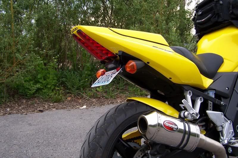

Post a picture if you can, maybe someone can see what happened. It should look like this:

Alright i took everything apart for inspection but I held the plate in its exact resting spot as it was after installation for the pictures. sorry for the crummy pics
ok so heres what I had to deal with upon installation...can someone tell me how you're supposed to screw the plate on then push the plastic spash guard up over it? Its physically impossible and as such I had to fit the plastic on the plate then screw it in making it hard to reach the screws.
here it is held in the installed position, you can see the clearance looks fishy but obviously not enough to get me worried when I first installed it....maybe my suspensions too soft?
I bent the plate back to its original position but its still a little deformed
