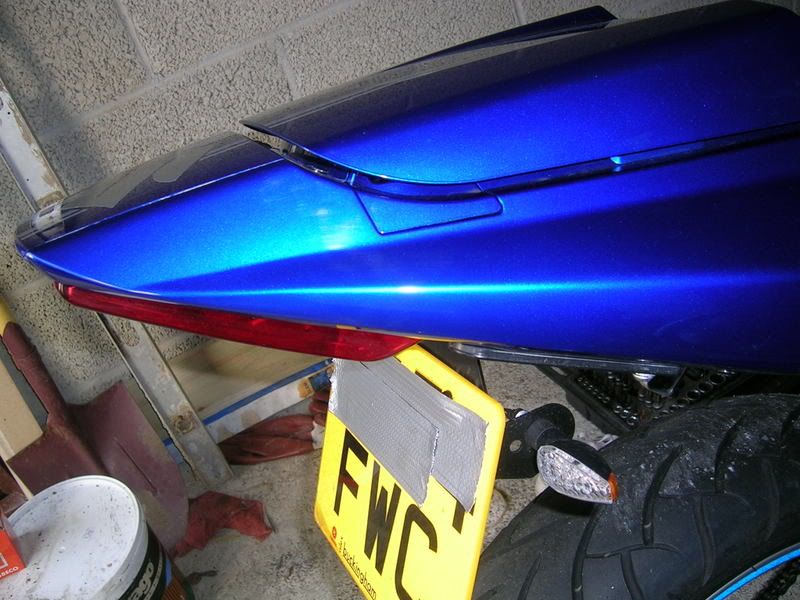

Right, firstly I bought this bike as it is now. I decided that I wanted standard indicators with clear lenses, so bought a new evotech tail tidy, and the oval hole for the indicator isn't big enough to fit the standard indicator bracket and rubber.
Am I doing something wrong or is the hole too small?
Rubbers dont fit in hole, and the plastic bracket shows how little room there is.

its the same tail tidy ive got... and ive had no problems at all with it possibly its the wrong year but not sure

Evotech do 2 versions...one for standard indicators and one for mini's.
It looks to me like the one for standard but not sure.
You'll need to make up a spacer for that plastic bracket to allow the indicators to fit tightly...I made one out of 5mm(or so) perspex-a drill,a file and voila.
Im not sure why your rubbers arent fitting properly...mine went straight in.
I would suggest asking for a replacement tail tidy-it might just be a manufacturing mistake.

I emailed Evotech, and apparently in 2005 the indicators got bigger, so as my bike is a late 2004 I've obviously got the late indicators. I need to get back to them, but I'm sure they will swap it.
