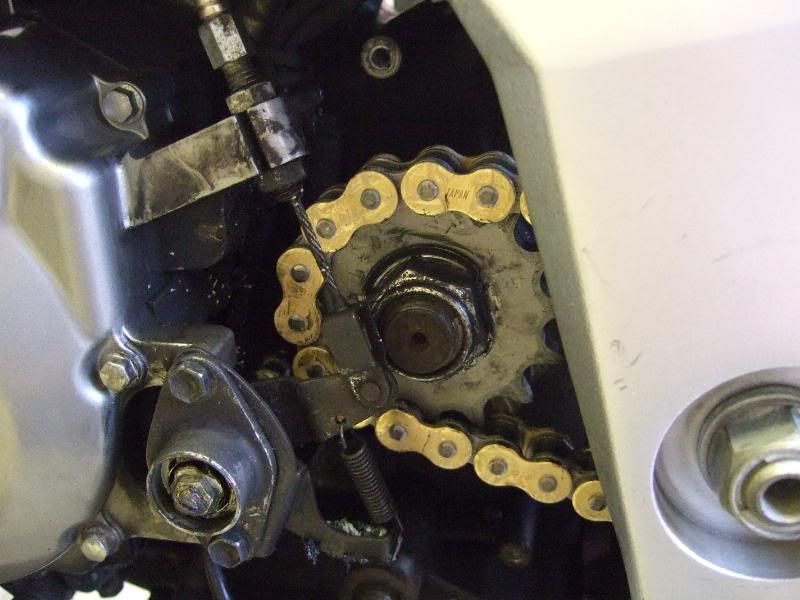

Can someone tell me what's wrong with this? He had to take off the two bolts to get at the sprocket bolt. What could be wrong?

What? The two bolts that hold the clutch bit thingy on? From memory that's normal on the SV.....

Looks OK to me (from memory). The clutch assemby normally needs to come off

So why is my clutch messed up?

probably cos lack care when reassembling to align with the slots on the spindle, or fecking around with the cable adjustment
it's not a big deal but if a garage did the work I'd get them to rectify it

Yes they need to break the chain, a drill to the link could be how normal people do it personally I use a grinder.
Clutch? Just adjust it as per a manual/sid squid. Slacken it off at both ends then turn out the flathead bolt surrounded by a locking nut that you can see in your pic of behind the front sprocket cover, then start doing it up until you feel it contact with something, then turn it out 1/8 of a turn and do up the locking nut. (IIRC)

If I turn it so the slots are on the other thread on the spindle it's way off. Don't think the cable adjusters were touched
No the chain was already split when I bought it. They had to drill the holes in the link to widen them. He said it won't go on otherwise
Oh I thought you meant to split the old chain.
Erm that sounds dodgy. What brand is the chain? The link is made for the chain it should fit through like a glove and then just needs to be rivetted
