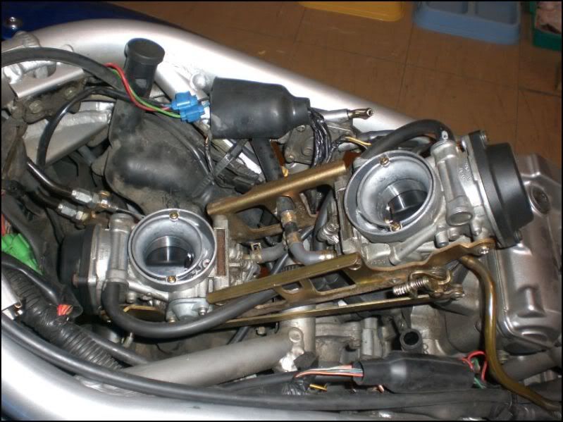

Here is a picture of the carbs from the right hand side of the bike note the TPS and fuel line.

Here's mine. Seem the same don't they?

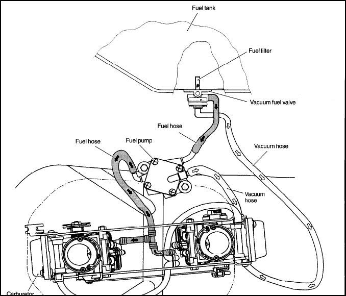

The issue I have is the fuel line from the carbs goes out to the right but my fuel tap on the tank is on the far left.
The fuel tap/pump arrowed at the top is on my tank not in the engine bay but the tanks I received didnt have a tap when I bought my SV in bits so I bought one from ebay and fitted it there where the haynes manual suggested.
Also the pipe arrowed below where does that go?

That unit you have arrowed is the fuel pump. The pipe from the carbs go to a lower pipe on that unit and then the top pipe runs over the top of the engine to the vacuum fuel feed from the tank.

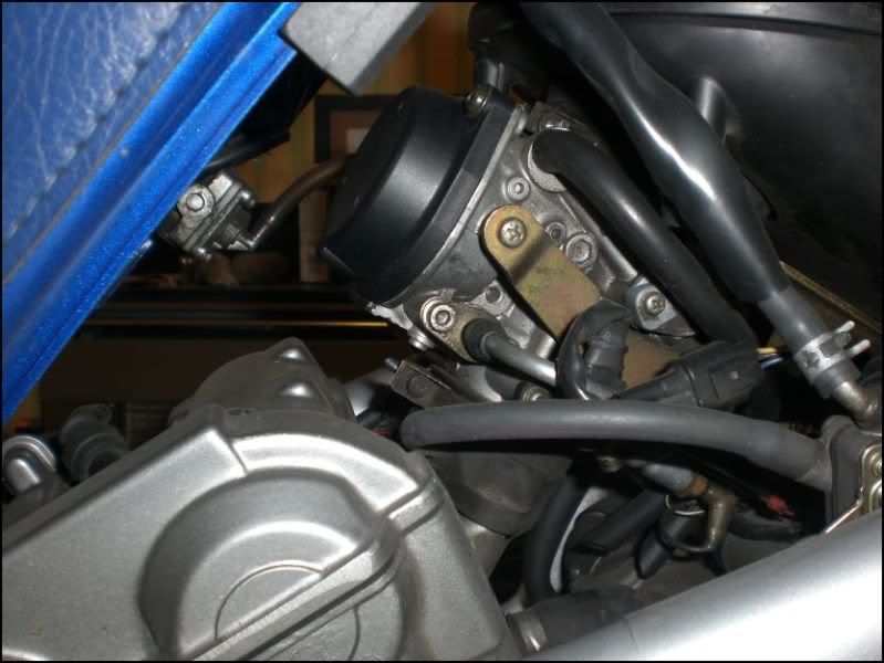

Old 21-11-09, 05:43 PM   #6
petevtwin650
Default Re: Carb positioning question
In this pic you can just see the fuel pump on the right and the vacuum unit on the far side

Just found this too
