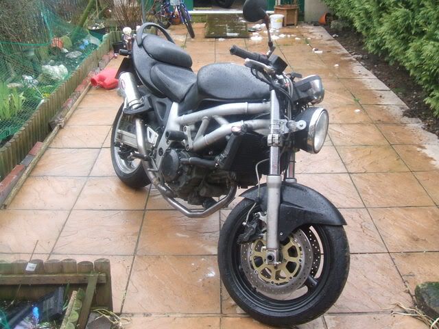

Default Re: Racetech emulators
p*ss easy to get hold of parts.
Cost depends which ones you want.
Best value for money is GSXR600 SRAD. Much better internals, brakes etc. It is what I have on mine.
Yokes £40 (I have spare set for this price + post)
Forks £80 or so
Wheel £80
Discs £80-100
Spindle £10
Calipers £40
Speedo sensor £30
reason it is cheap is you can sell your SV stuff on when you've done the swap, making it pretty much free.
Looks like that
