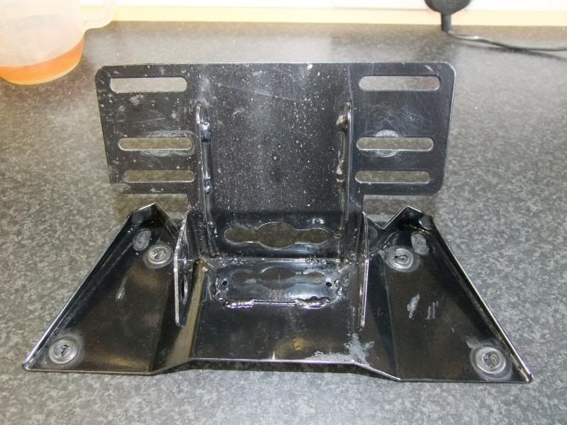

Well I got round to sorting my bike out after being sold an incorrect under tray/battery tray as my original was modified for an aftermarket under tray.
Still awaiting a new number plate but thought I would get on with what I could do.
I started by putting everything back on the undertray including the battery, fuses, ecu etc... and fitted the brackets on for the R&G Tail Tidy
Then fitted the rear tail section back on, already looking loads better, shame you have to ruin it by putting a number plate on really. You can just see the brackets through the gaps to be able to put the other section of the R&G tidy on.
Next up the indicators I got from Powerbronze at the bike show at the NEC after seeing them on the stand, they were bright and looked well made. Fitted them on the tail tidy and fitted the tail tidy to the bike as instructed, this is where everything started going wrong
As you can see 3 bolts are in, but one is not lining up as it should be from the pic below, you can see it coming from the rubber slightly

R&G must have updated their bracket design. Mine didn't look like that and was just in one piece. Sorry can't help with that
Old 28-12-11, 11:46 PM   #4
N77
Default Re: Tail Tidy & New Indys Fitted with Probs!
So you didn't have the 2 pieces that connect to the rear frame?
Old 28-12-11, 11:58 PM   #5
Just checked and I think it was a hamicad one I had, sorry

i had such issues fitting my r&g tail tidy and it still doesnt look 100% to me but loosen everything off and start with the off bolt just a few threads in then the rest....also prepair for lots of swearing as you have to take the fairings on and off 10 times.
