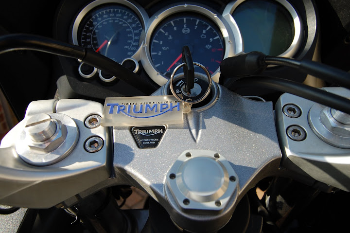

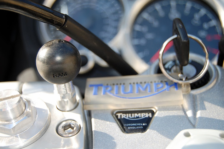

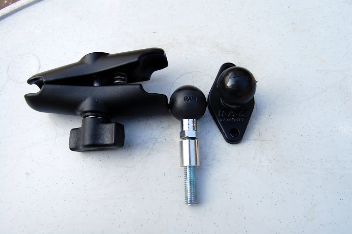

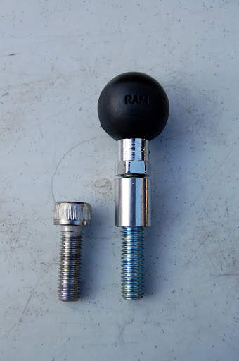

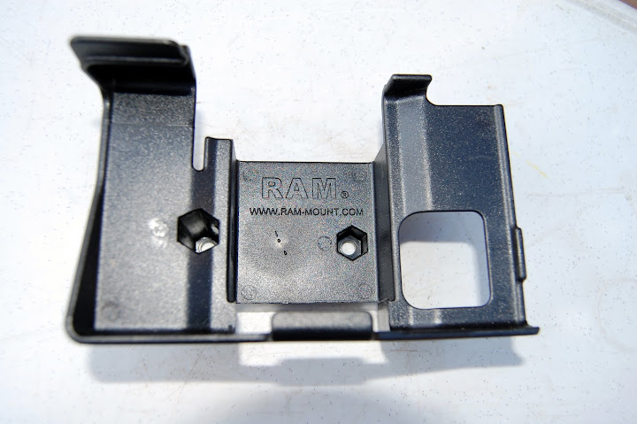

mattSV 26-09-09 04:16 PM
Re: Mounting Sat Nav on a Pointy.

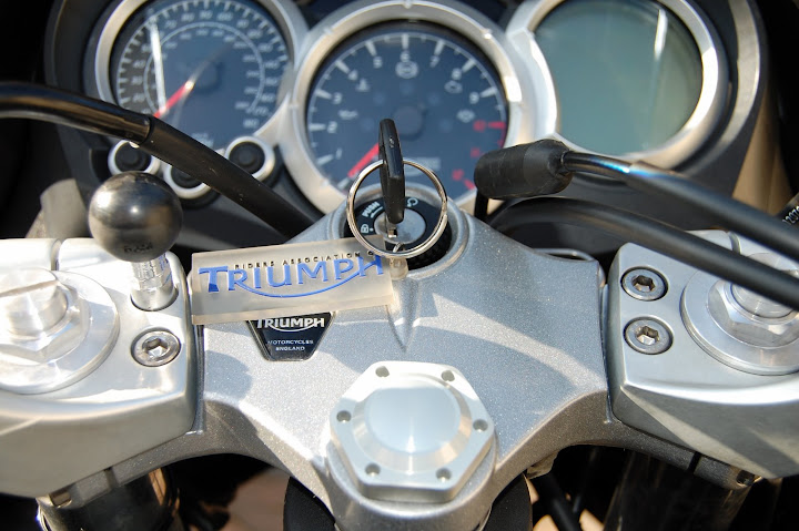

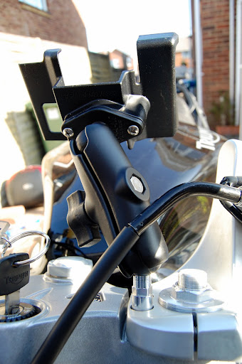

Just fitted a mount for my car satnav on my sprint st (garmin 670).
Had a look at the RAM mounts and got totally confused - there are bloody hundreds of different options.
In the end i picked up the phone and had a chat with Bob from:
www.telferizer.com
He really knows his stuff - told him what bike and what satnav, and he recommended a few bits - two days later they were on my doorstep:-
http://lh4.ggpht.com/_21eccP-FJ2o/Sr...0/DSC_0026.JPG
http://lh3.ggpht.com/_21eccP-FJ2o/Sr...0/DSC_0034.JPG
The ball mount repaces on of the bolts between the handlebars & top yoke:-
Before:
http://lh6.ggpht.com/_21eccP-FJ2o/Sr...0/DSC_0027.JPG
After:
http://lh6.ggpht.com/_21eccP-FJ2o/Sr...0/DSC_0030.JPGhttp://lh5.ggpht.com/_21eccP-FJ2o/Sr...0/DSC_0031.JPG

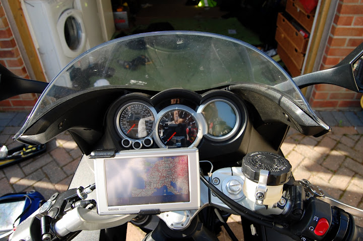

Compare & contrast:
http://lh5.ggpht.com/_21eccP-FJ2o/Sr...2/DSC_0029.JPG
Two minutes later it was all connected:-
http://lh3.ggpht.com/_21eccP-FJ2o/Sr...2/DSC_0039.JPG
http://lh4.ggpht.com/_21eccP-FJ2o/Sr...0/DSC_0040.JPG
After a bit of adjusting, I have got a full view of both the GPS and the clocks, even with a tankbag.
Total cost for all the bits was about £60 +p&p.
Have now got it wired for power & sound through the Autocom, works a treat. It is at the ideal height to be able to see it clearly enough without having your eyes off the road for too long.
If you need any advice re mounting a satnav, pick up the phone to Bob - details below:-
