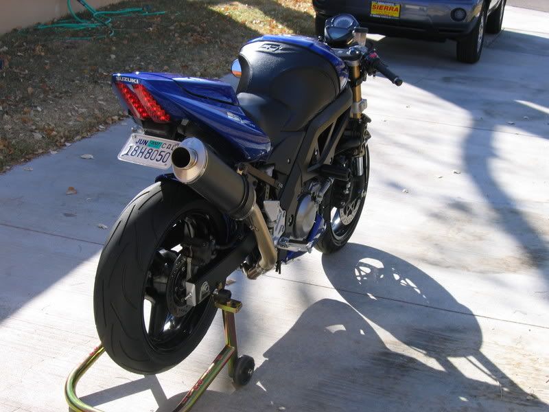

I will be moving to Mildenhall in August or thereabouts. I'm coming in from California. I have a 2005 SV650 I'd like to bring with me. I put a lot of time and money into this thing and don't want to sell it just yet. Is there anything major I'll need to do to get it street legal? Lights, exhaust, etc. Thanks in advance for your help. Here's a couple of pics:

Nice bike , am getting a red one and would like to do it in similar way, questions later .

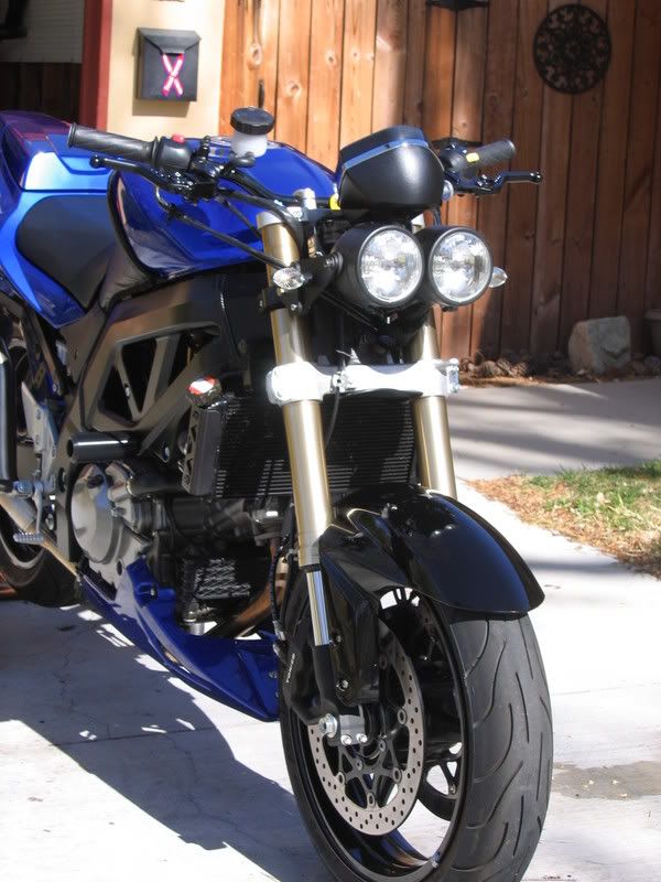

re your bike, what exhaust is that, can you fit the back pegs? what headlights are those?
i hope someone on here will advise you on the size of numberplate and the legalities of your exhaust. your bike is new so no need for MOT check till it's 3 years old.

Looks pretty close to what you need to import it, I should think you need some mirrors, a rear reflector and a stamp on the exhaust saying it is for road use.
As it is a black frame pointy (BFP i guess) it will not need an MOT for atleast a year so maybe it is easier.

AFAIK - you'll need an exhaust that isn't marked 'off road use only' and isn't 'excessively loud' - which is a bit subjective. You may need to change your headlight if it dips to the right - if it dips straight ahead it should be OK. And (someone back me up here!) if you don't have a pillion seat, you don't need pillion footpegs - so keep the seat cowl on. Assume you have a MPH speedo anyway? You'l need a red reflector at the back somewhere. So not much cost involved =-and you could probably borrow a legal exhaust if you need one. Your bike looks way too good to leave behind!

Some police forces get the hump about exhausts that aren't 'e' marked which yours won't be as it is all federal spec. It might be an idea to make sure that the headlights are dipped to the left so you don't blind oncoming drivers but as there are so many US spec cars and bikes running around in that part of the country I don't think you'll have too many problems - my aunt drove round in a completely unmodified federal spec 3-Series without issue before shipping out to Texas.

Nice bike... What make is that exhaust?
