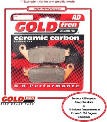

hey .orgers
im looking at geting new pads on the front of my curvy but there is to many, i will be geting my pads from wemoto.com but they have loads which are best i dont mind the price as i could get any of them
so which of the belowe are the best ? or what is the diffrent between them ? also what is HH & GG ?
EBC Sintered (HH Type) (http://shop.wemoto.com/pictures.dyn?u=1915475qqq5828050)
EBC Standard (GG Type) (http://shop.wemoto.com/pictures.dyn?u=1915475qqq5828047)
Goldfren (HH Type) (http://shop.wemoto.com/pictures.dyn?u=1915475qqq3601595)
Pattern Standard (GG Type) (http://shop.wemoto.com/pictures.dyn?u=1915475qqq5828056)
any help would be great

Organic (GG) pads are equivelent to original equipment type pads. They last well, don't wear the discs badly, but some feel that the bite and power they offer is less than that offered by more aggressive ones.
Scintered (HH) pads can offer better bite and outright power, but some feel that they wear discs more aggressivly than they like, and they may not be quite as good when cold. Think of them like sports tyres, not for everyone's needs, but most think they're a useful choice.
For what it's worth I'v used EBC and Goldfrenn and they've both been fine (though neither on an SV).
Lozzo reccomends Vesrah pads as they're often OE pads which then have other people's names written on them. A few people use Hein Gerricke pads as they seem to be Carbon Lorraine pads re-badged.
