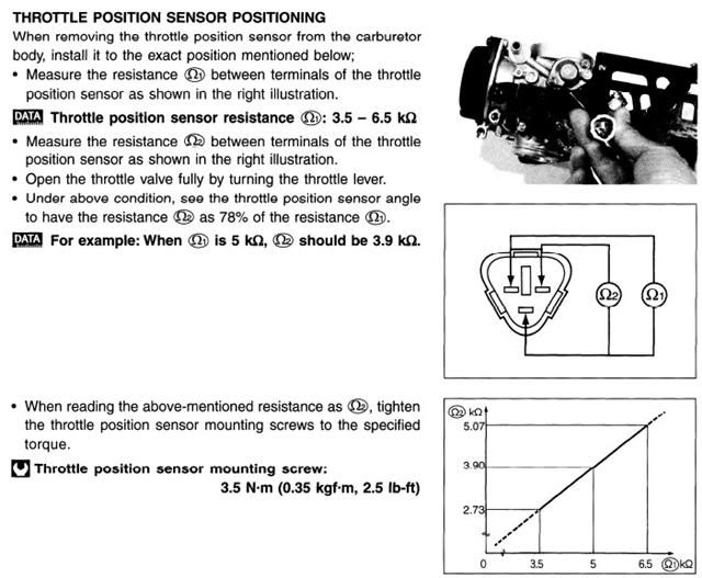

There is a setting procedure for the TPS on the carby model.
You'll find there's not much adjustment on the slots, but get it as near you can, it's not over critical.
