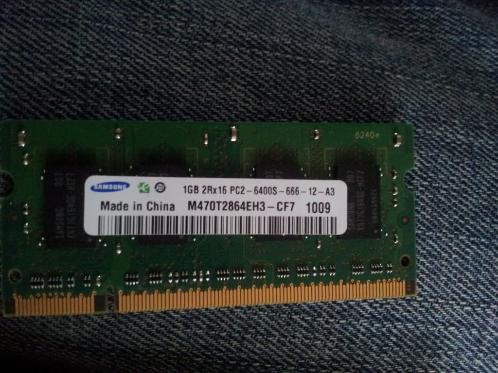

I want to upgrade the RAM in my Samsung N510 netbook. Below is a pic of the current module that is in there.
Would this fit?

I would go to http://www.crucial.com/uk/ for the memory, rather than ebuyer. You should be able to select the make/model and it will tell you exactly what you can put in the machine.

can recommend crucial as well, looking on the site though its says the max amount of RAM you can install is 2GB. might be something worth looking into before you buy the 4GB in you links above:
http://www.crucial.com/uk/store/list...l=N510&Cat=RAM

No its DDR3 and you have DDR2

Cant gurantee but it should be fine, ususaly you can go for the same or faster speed than what you have but specs go further to CAS times and memory layouts that are allowed by the bios in the computer.
As Sudoxe said just go to crucial website as they give 100% gurantee if you choose though using the memory selector for you computer type

Thanks for the input. Looks like I can only upgrade to 2gb. I thought RAM was backwards compatible, you just wont get the faster speeds cause you wont be able to select them in the BIOS.

Very much depends on what the bios allows as its a laptop you wont have much to fiddle with and it will take the settings that are specified on the memory. Laptops are much more picky about memory than desktops.
Somtimes you can have mismatched speeds and the system will just use lowest speed that you have installed.
Memory is rated UpTo a certian speed, this spec is then written to a chip on the memory module and used by the bios to set all the params as required.
Its all a tricky business.
I checked the N510 can support up to 4GB of ram but only in a single chip as it only has one slot, btw no point installing a x64 OS as after 256Mb thats taken for your graphics you are on the limit for a 32bit OS realy so no need to put an overhead into your system.
