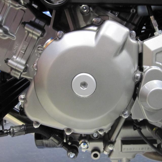

Hello,
While I was trying to check my valve clearance, I snapped the head of the torx bolt so had to remove it using vice grips.
Now I need to buy this and can not find it on ebay, is there a website apart from stealer which has all parts and bolts in the UK ?
or is my only option stealer?

What Torx bolt, where is it? Are you referring to the 10mm hexagon recess aluminium plug in the side of the alternator case, or the 8mm hexagon steel recess plug in the top?

I think it would be the 8mm hexagon as pictured below. it is the one on top where you can read the F and R mark
http://www.msa-direct.co.uk/ProdImag...GBR-p3-640.jpg

Suzuki dealers sell Suzuki parts.

09248-16012
part number
£4.27
On offer at moment, robinsons foundry (new price £1.57)
HTH
