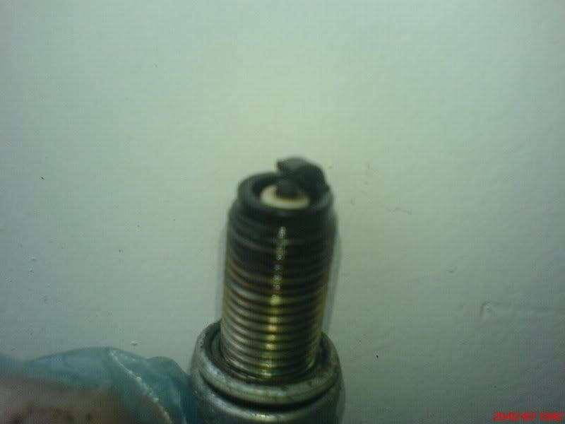

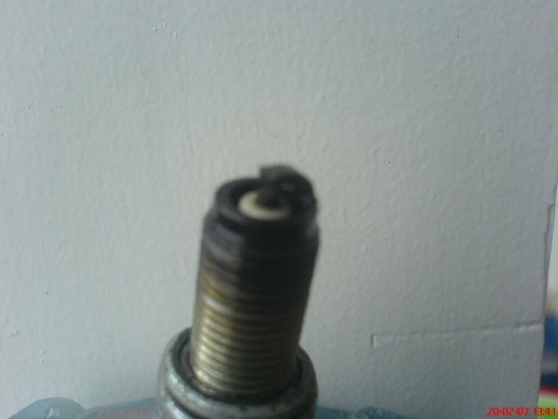

As regards fueling, these are pictures of my rear spark plug - to me they look fine, perhaps someone else could confirm or otherwise.

If you know my exhaust, I don't think your "fuel" one could be less restrictive than mine. My spark plug pics wwere supposed to confirm that you won't need a re map (if someone can confirm they look OK)

The spark plug looks ok to me. I've also heard stories of valve/shim damage by a wrong air/fuel mix... maybe that was scare mongering... hence why I'm asking the org
