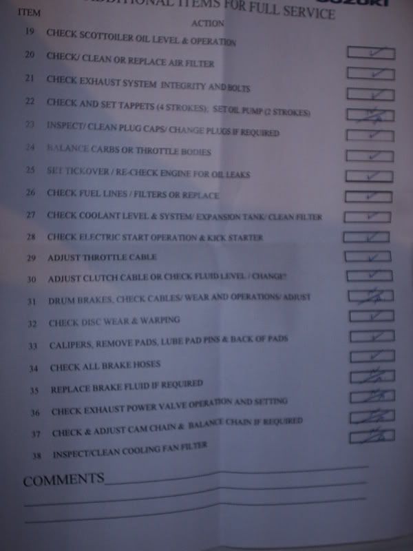

I took mine to Cupar Motorcycles (Suzuki dealer) which is where the bike originally came from, so I want to keep the stamps in the service book the same. They charged me just over £200, and I am wondering if this is about normal?

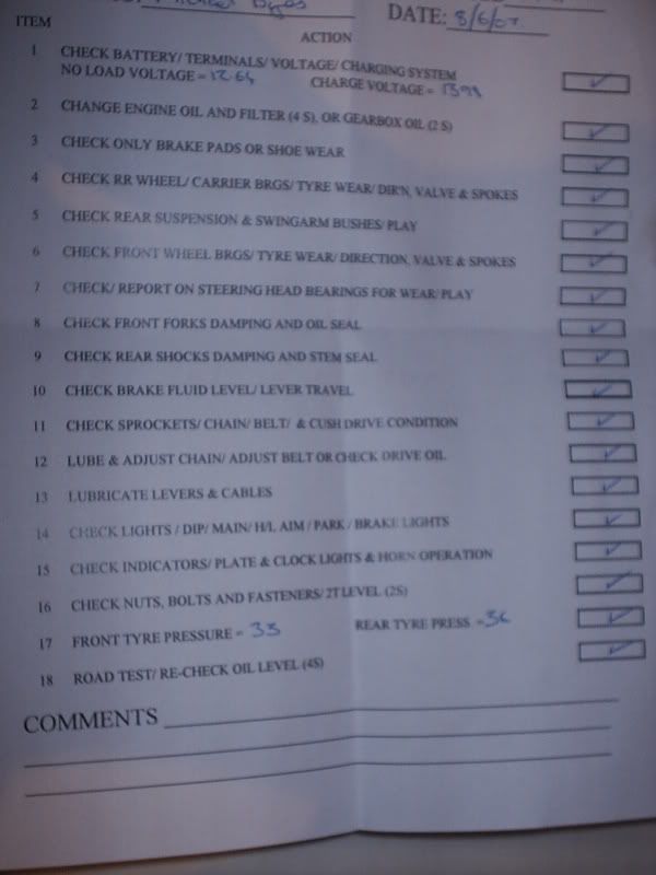

The bike is a K3 but registered in 2004. Here's a list of what they carried out

Morning all.
Was there much difference with the bike after the service? For £200 there should have been!
Looking at the list it was mainly checking, which is ambiguous to say the least. Do they check brake pads by just gawping at the edge with the calipers in situ, or do they remove the calipers, and inspect the pads properly? It also appears that they didn't change brake fluid or coolant, it should be every two years, although I prefer to do it annually.
My 7.5k service can cost that sort of money if the bike needs a full complement of service parts, & a set of pads or two, but people do notice a distinct difference afterwards. It can also be done while you wait, so you can get dirty too.
