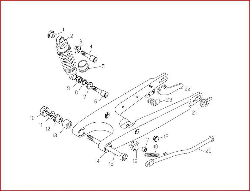

i need to change the bush in the bottom of my shock on my TRIALS BIKE, but i cant undo the bolt, there is no linkage, the shock bolts to the left swing arm, and the allen key bolt is resest in the swing arm (page 6 bolt 6) if anyone can post the picture that might help, i dont know how

There may be someting on this website that may help!
http://www.lawson-his.co.uk/scripts/...emoval%20Tools
Good luck.
Pete

thanks for the picy pete i had a feeling you would be able to do it
