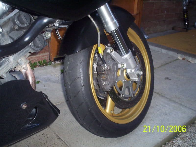

What I used on mine!
1998 SRAD 750 forks
1998 SRAD 750 yokes with the SV stem pressed in
TL1000s clipons
TL1000 wheel and spindle
TL1000 mud guard
2000 GSXR 4 pot callipers
And a speedo pickup from the USA climb.high@verison.net

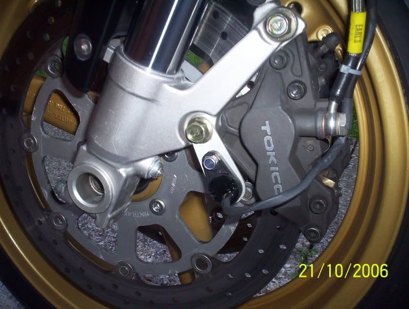

The speedo pick up

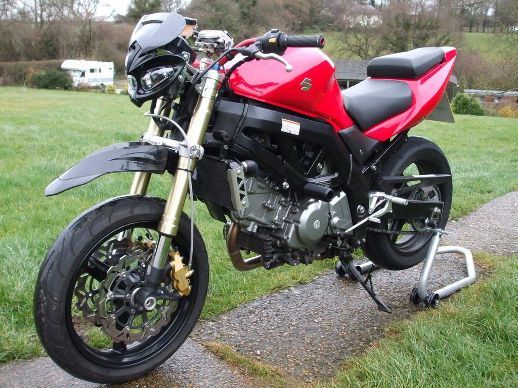

GSXR 600 K4 forks, bottom yoke/spindle, brakes and front wheel - all go straight in with no modification. I've done a straight handlebar conversion with an LSL top yoke so not sure on drop bars, and I've used aftermarket Braking discs, but they are direct replacement for the standard GSXR ones. Very, very easy to do. Only headache is getting the speedo to read correctly, still not sorted. I've also added the GSXR steering damper since this photo was taken.
