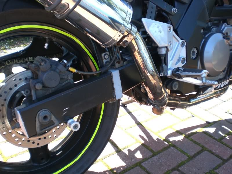

Hi, I'm new to everything...I've had an SV650s K3 for a whole 3 weeks now (after 9 years in the car driving wilderness), and I'm new to this site (but have found it brilliant for general questions) and I was wondering if I could get some assistance.
I ordered a genuine suzuki rear hugger but when I went to fit it discovered that the hole on the right (brake cable side) was in the wrong place. I went back to the shop who swore up & down it was the correct hugger and I've lost 20% of the price returning it.
How can I tell if the swing arm has been changed either for a none k3 or a none suzuki one?
Thanks

This is the swingarm of an 05 Sv. i presume it's the same as an 03 apart from it being black coated. Does this resemble your swingarm Beanie? And are you sure it's a K3 and not a late registered Curvy?
