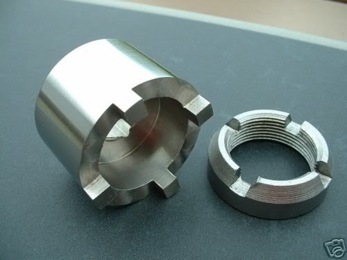

special tool, axil stands, grease, bearings.

Whats the special tool, i'm gonna order bearings when i'm at the garage as i can't find some of them on simply bearings.

http://cgi.ebay.co.uk/NEW-SUZUKI-SV6...A1%7C294%3A200

Anyone got one of these i could borrow for a day? The guy wants £25 for them!!!
You already own the bit on the right, its £20 just for the left one

yup... simply dont list them.. could always give them a phone... they are a weird size..
another thing you could try is just packing them with grease... how many miles has the bike done?

Don't use the smaller bearing it needs to be right size. For castellated nut just take a grinder/dremel to a normal socket.
