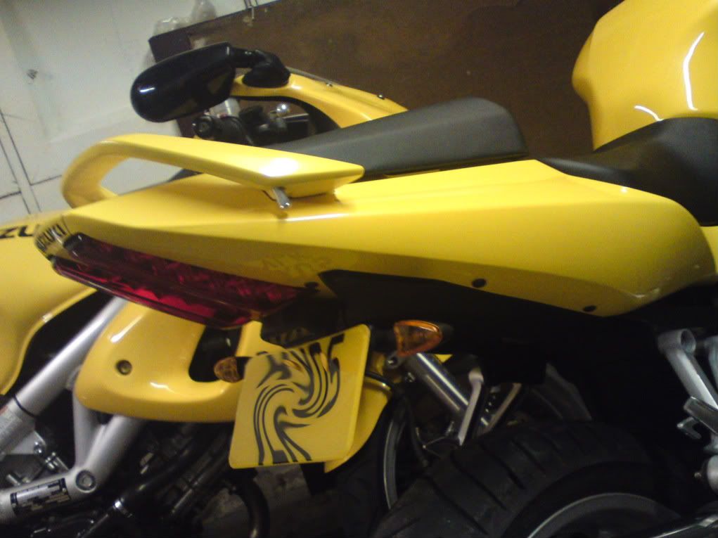

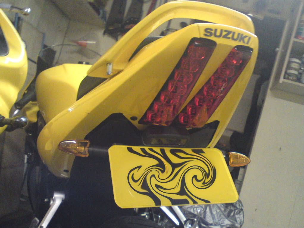

Just bought myself an ermax undertray and then realised i have know idea how to fit it? It cost me £20 and the colour matches my bike so i thought that i might as well
http://cgi.ebay.co.uk/ws/eBayISAPI.dll?ViewItem&item=320448509775&ssPageNam e=STRK:MEWAX:IT
Can anyone give me any tips or advice on what parts need to be stripped off to fit this thing?
How do the flush mount indicators work? do they have bulbs in or do you use the bulbs that are already on your standard indicators?
Will i have a problem mounting my numberplate?
Can i buy a set of flush mount indicators for the front to match the ones that are on the ermax undertray?
thanks ian
My rear end
