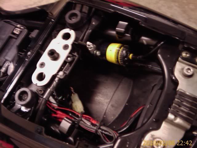

Should have let me know. I have an R&G and you could have looked at mine.
I have the fuse box in a plastic bag and all the cables tied together to keep neat. The tank prop is located in my shed now. If you want a look at mine just let me know. I am off work for a few days so popping round is no problem. PM me if you want my number.
I think I have a piccy, I'll have a look.

Here you go. Sorry it's a bit blurred but it was taken with a phone.

Default Re: R&G Tail Tidy questions
No you wont. Take a look at mine tomorrow if you like.
