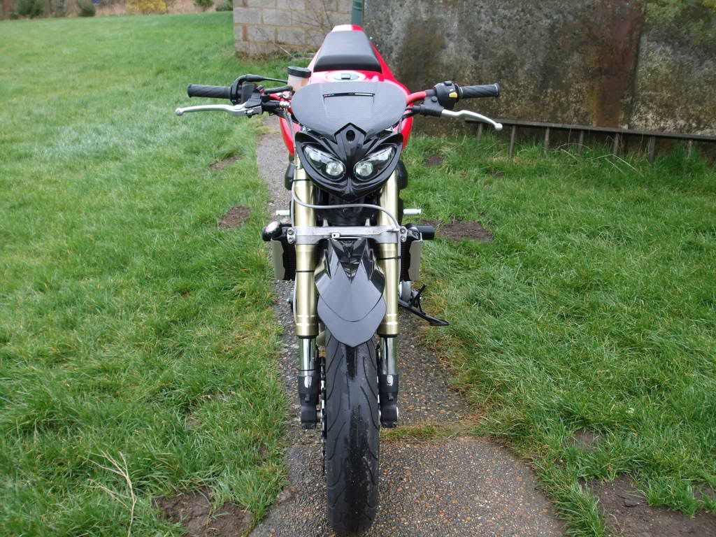

I know this question has already been asked but i want to get the experiences and as many close up pics of sv's with gixer front ends and also rear shocks. Sorry if this has been asked before but it's the pics i am after. Looking to change the front end and rear shock next year now as i have to pay for the paint and new bits i have discovered need changing while re-building!

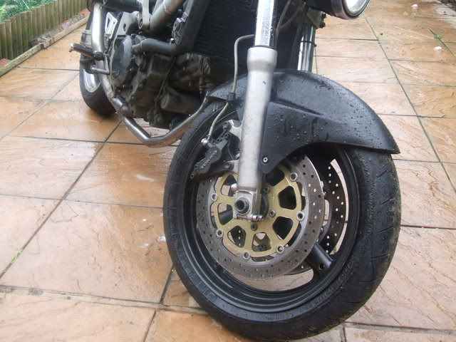

sv-robo
Default Re: gsxr front end! Again
Kinell yc!! that downpipe is scarely clean for you(expected it to be full of carp).......me thinks under all that bravado you may have a little cleaning fetish going on
Old 08-11-09, 12:25 PM   #4
Lol dizzyblonde cleaned it for me that day. My bike is actually quite trick under all the grime
Old 08-11-09, 04:07 PM   #5
Red Herring
Red Herring's Avatar
Join Date: Dec 2007
Posts: 2,708
K4 GSXR 600 on a K5. Rear shock is either off the same bike (K4 600) for the track or a 750 SRAD on the road. Both go straight in with only minor mods to the undertray.
Old 08-11-09, 04:13 PM   #6
Red Herring
Join Date: Dec 2007
Posts: 2,708

Originally Posted by Red Herring View Post
like that, what mods did you need to do for front end???
Old 08-11-09, 05:21 PM   #8
Any will go in you just need different speedo and top bearing (you don't on a pointy).
To fit any SRAD or newer stuff to curvy you need to buy a top bearing conversion from Zoran at twin works factory. It is easy mod. Then everything bolts on as if it was meant to be.
P.S if SV race shop still sell their copy of that bearing, don't buy it there.

Old 08-11-09, 05:46 PM   #9
BomBalong
so if i was to do this to my pointy it will bolt straight on and i will still be able to use my OEM speedo?
Old 08-11-09, 05:47 PM   #10
Speedo yes, not speedo drive. You will need to add some magnets in disc and a sensor.
