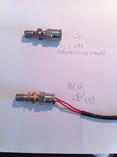

the guys at york suzuki said I might be able to bleed through the banjo bolt if I'm careful - just to get it through MOT and then sort the POC when the bike isn't going to be ridden (winter time)... But HEL Northern Ireland have managed to feck up yet again, they sent me a new brake light pressure switch with the wrong pitch/thread on it. Took over 2 weeks to arrive and it has just transpired it's the wrong part... nob ends!
Thanks for the tips guys, not got much time to get it sorted before the AR!
