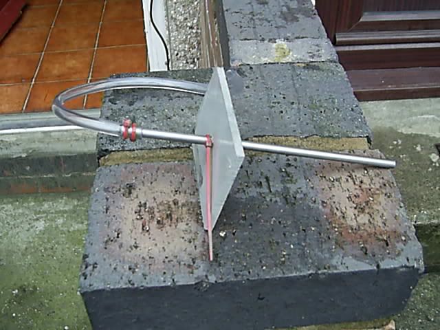

Firstly my damper rod had 4 holes already at the correct size so only 2 more to drill each side. Then unfortunately the oil lock piece jammed in the fork so I had to fully dismantle one side To replace the new fork seal I bought a length of gutter downpipe from Wickes which was a perfect fit. Also Lissa cut some pieces to use as height measures for dropping the forks through the yokes. Presently at 5mm to the top of the tubes, not caps. Lastly I purchased a short length of small bore tube and pushed it through a bit of of ply. Using cable ties and tubing I have now got an air gap tool that using a syringe, or in my case Mityvac, draws the oil out so you have equal and accurate air gap in each fork leg.

Pics below.
