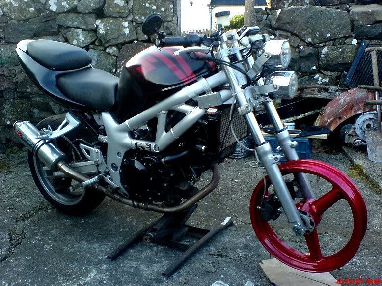

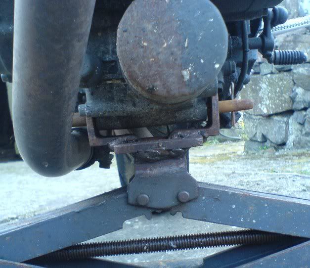

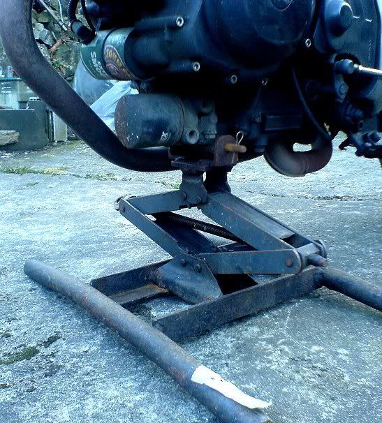

As stable as a very stable thing. No need for the paddock stand, unless you're actually taking the rear wheel off too.
And you don't need someone else around to steady the bike, just slide it thru the casting while on the sidestand, start winding and hold the bike upright for the first few turns. Easy.
Cost: £nowt.
Lovely close-up of crud and some baaaad welding
