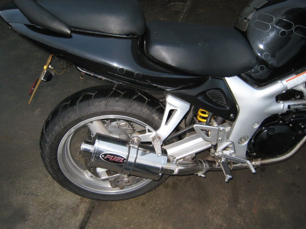

job done looks good an sounds good(in my opinion!!)

that looks ace! thought it would look rubbish with out being a high level
how long did you make it?, shame about where the strap is
might do mine at the week end

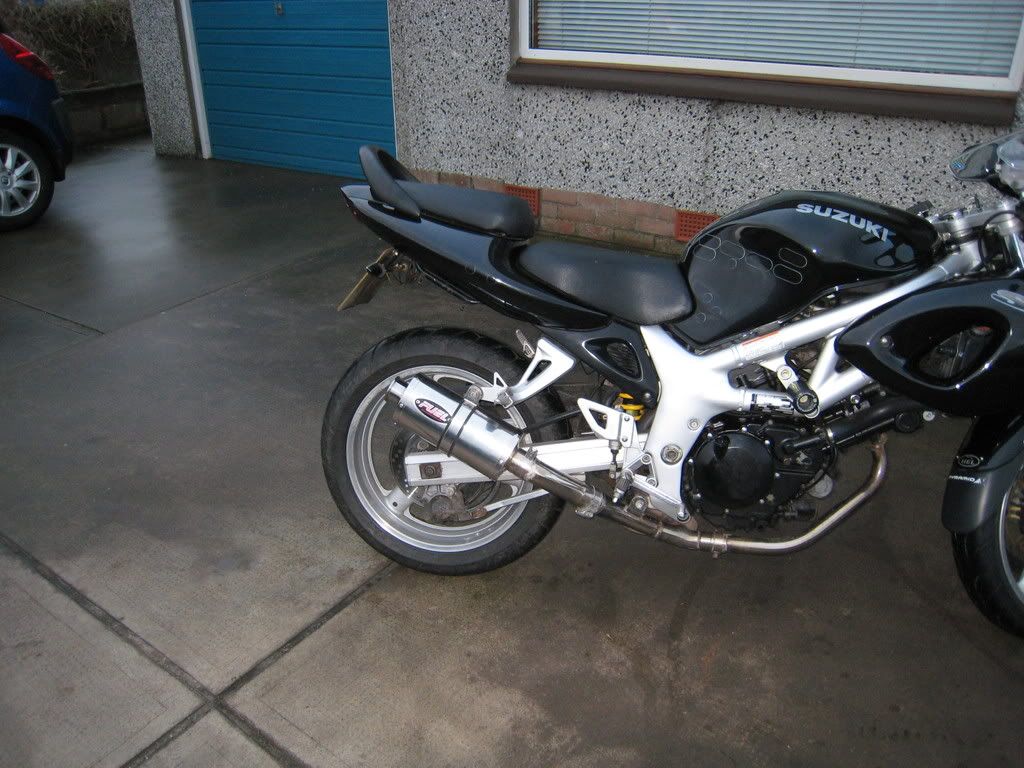

i took about 7.5inches off i did it like yorkie chris by taking off the bottom cap and cutting out a section on the bottom but if i was doing it again i think i would take off the top cap and cut the top because the center cylinder bit of the exhaust was a b**ch to get back into the top end cap maybe worth taking a note how far the center cylinder tube goes into the end cap.hope this makes sense

why was the tube hard to get back into the top cap? and how did you eventually do it?

well it was just hard to get it lined up right, patience was the main thing then start hitting/taping then end cap in. Like those before i had to cut notches in the end cap and bend them over a bit to aid getting the end cap into the exhaust. N.b. also hard cos it is a tight fit in the first place!

Looks cool mate, bet it sounds the mutts danglies too.
