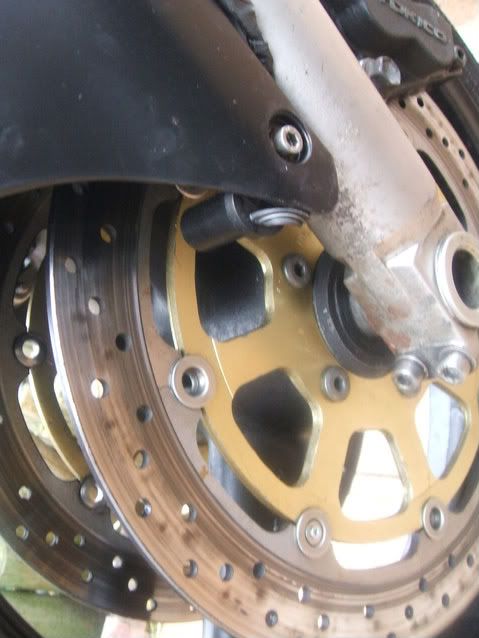

Speedo yes, not speedo drive. You will need to add some magnets in disc and a sensor.
how would you do that and is it accurate??
Old 08-11-09, 05:57 PM   #12
Default Re: gsxr front end! Again
Bolt 4 magnets into disc rivets
Old 08-11-09, 05:58 PM   #13
Same accuracy as stock.
Old 08-11-09, 06:01 PM   #14
liamsimpson
are these an item readily available or do they have to be fabricated, and will it plug straight in to loom?????
Old 08-11-09, 06:10 PM   #15
You need to wire it up to OEM connector if you want it to plug in like that. They are standard part from farnell components.
