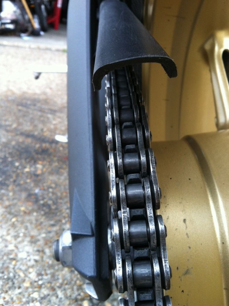

Default Re: Chain noise
What you gotta bare in mind (I'm making assumptions on your maintenance here as 90% barely clean their chains) that a clean chain, and I'm talking spotless and new, doesn't have a fist full of gunk all over it like most normal chains...so weird noises will happen as it's metal on metal with little to nothing to dampen the sound. Here's a pic of how my Street Triple's chain spent it's life - never once had to adjust it:
93 VFR750 - WAY too many mods to list. Crashed
04 SV1000 - Bar end mirrors. Belly pan. Seat cowl. K4 GSXR600 K6 front end and custom top yoke. R6 Brembo MC
650 is offline   Reply With Quote
