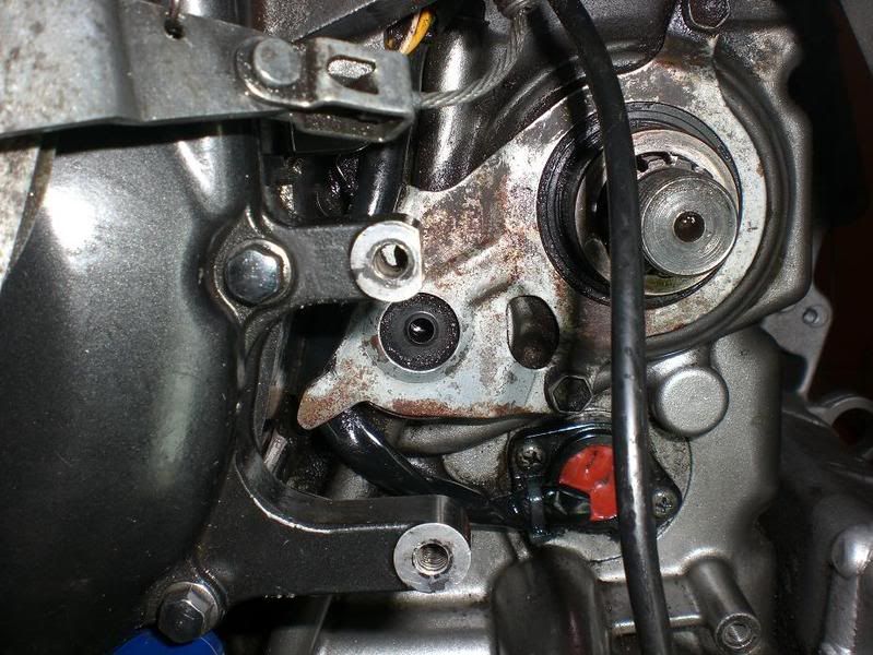

petevtwin650
Default Re: Front Sprocket Removal Help
On a curvy it's held on by two 10mm headed bolts. Presume it would be the same on yours Rob.
Pic of it off.
