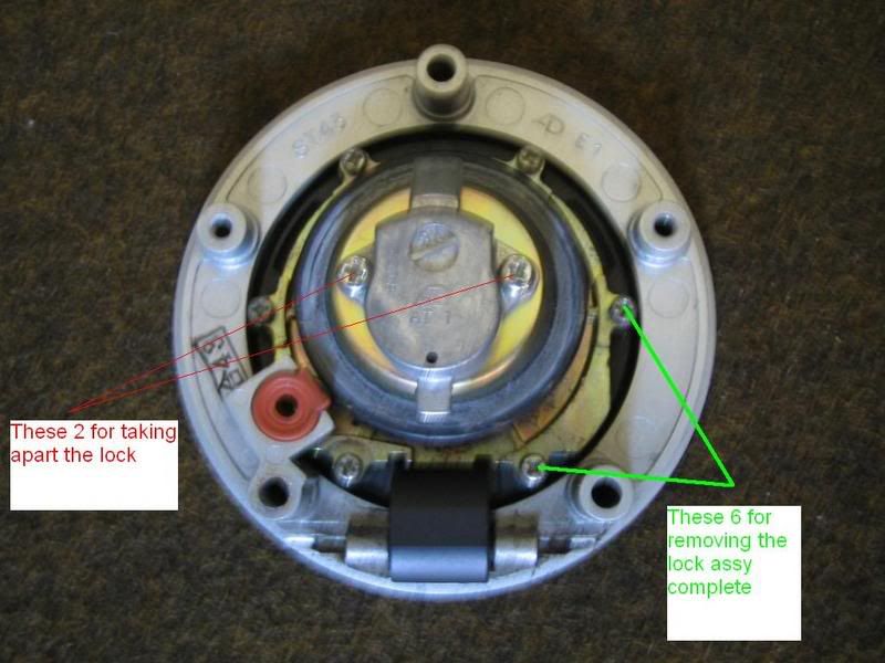

ianofbhills
Default Re: Has anyone ever removed the whole petrol cap?
I had one sitting in the garage so i've had a look and took some pics for you.
the whole lock assembly can be removed by taking out the 6 smaller screws i suspect this is the easiest option
the actual lock itself can be taken apart by removing the 2 larger screws
the metal surrounding ring is attached to the cap via a hinge pin which could probably be drifted out and back in again if you were carefull.
if you want this one pm me you can have it as i dont need it.

haggis
If it's just the silver ring you want to remove (curvy or pointy) then drift out the pin across the bottom of that pic. I think I used a 3mm punch.
Mine was flaking so i did this, it works.
