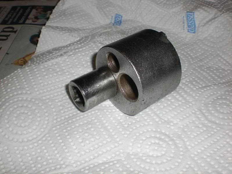

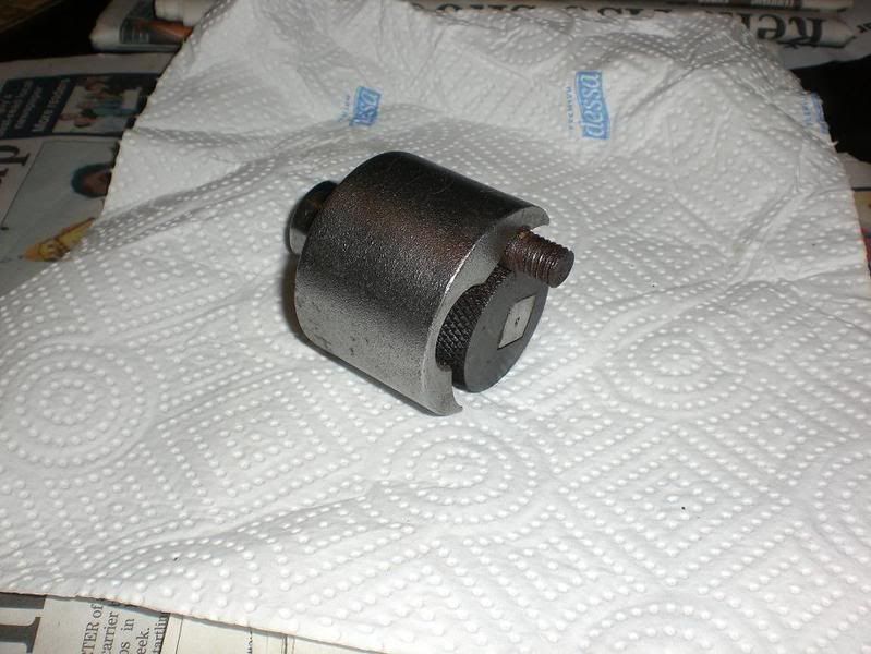

One of these?

I've got the stud remover (as seen above), and I've been spraying it with some plug gas every day. Though I'm going to have to drop the exhaust off to get to it, else there will be no room to grip and turn the stud.
