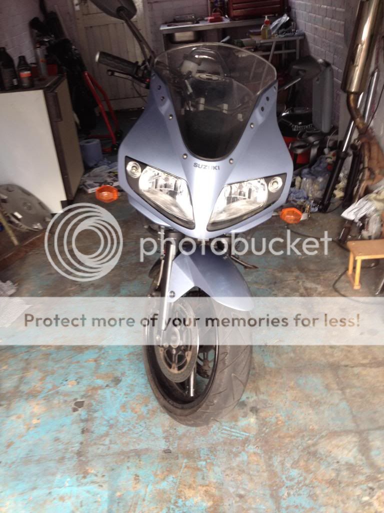

The project has FINALLY been complete! The bike is back together and had it out for a test ride today.
So, rebuilding the fork was easy after reading the instructions properly and not filling the damper rod with fork oil

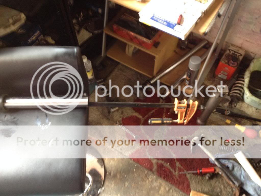

Then, I put the damper unit and fork sanction back into the SV lower leg, and tightened the damper unit up with the trusty long clamp

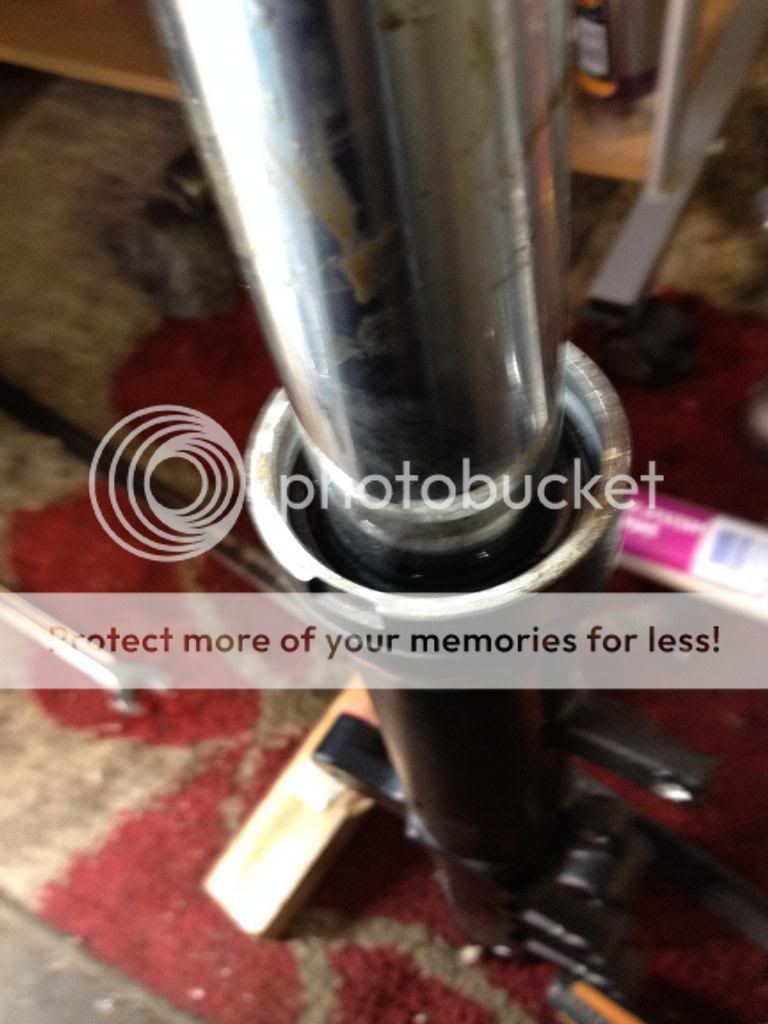

Now for my home made, cheap, fork seal driver. Basically, its a 40mm drainage pipe with a long cut down one side, slide it over the top of the fork, down to the seal, make sure the fork sanction doesn't bash against the bottom and slide the fork sanction and pipe with some force into the seal and there you have it! a £2.99 fork seal driver!
Followed by the retaining clip and dust seal. I made sure a slight smear of fork oil was between the seal and sanction for easy gliding.

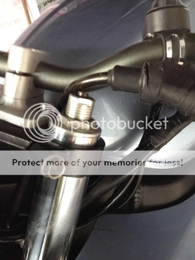

All easy enough apart from the fork height above the top yolk, unfortunately, the clutch cable isn't allowing me to pull them through by the 25-30mm to accommodate for the height difference in forks (see earlier in the thread).
Easily fixed at the end of the day by getting a new clutch cable without the metal curved tube and rerouting it.

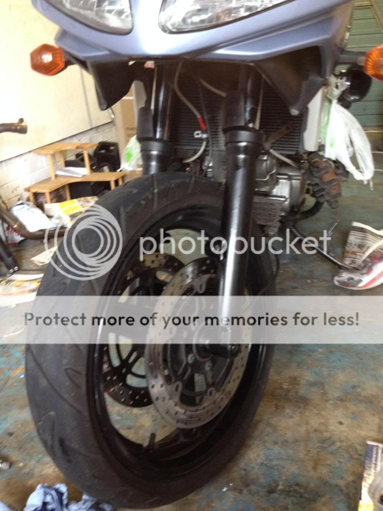

This is where I started to realized how awesome that satin black looks on the forks!

WHAT a difference! No more diving like a sub under heavy braking and the initial turn into corners really gives confidence! The brakes feel more responsive as well without the weight of myself and the bike being thrown onto them.
Admittedly, the ride isn't as comfy as before, it's not full on rock hard, more like a stiff suspension feel, but its a sacrifice for awesome road handling!
I'm incredibly happy with the way the front end has been transformed to a proper confidence inspiring bike!
