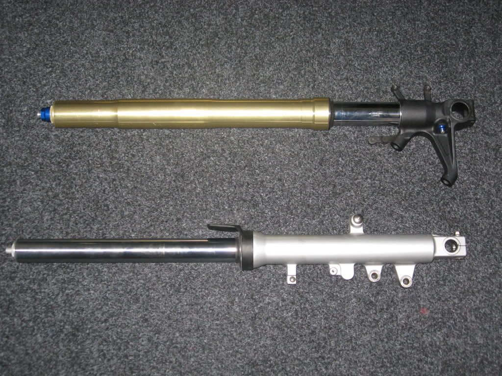

Originally Posted by amnesia View Post
GSVR vs SV...
There is like a big difference in length inbetween the GSVR and the SV forklength! Just a small question: does the fender touch the radiator on heavy braking? I have this problem with my sv with R1 forks... Although the uncompressed length of the R1 forks was almost the same as the SV ones, but the stroke is longer...
Anyway, I like the blue bike and the gold forks with the black frame/wheels!!
Old 16-08-08, 12:17 PM   #64
amnesia
Default Re: K6 Pointy GSXR Front End Mod
The difference in fork length isn't that much really, the photo is misleading as they aren't level.
The fender is nowhere near the radiator, but I don't have an extender fitted yet. It is a GSXR fender though. I have bounced on the front end quite hard, fully compressing the forks with no interferences.
My fender was fine even with the extender fitted it was nowhere near the rad!!!

Dangerous Dave
Clearance is only an issue when you start dropping the GSXR forks through the yokes, as they are shorter than SV forks anyway the majority of people have no need to.
