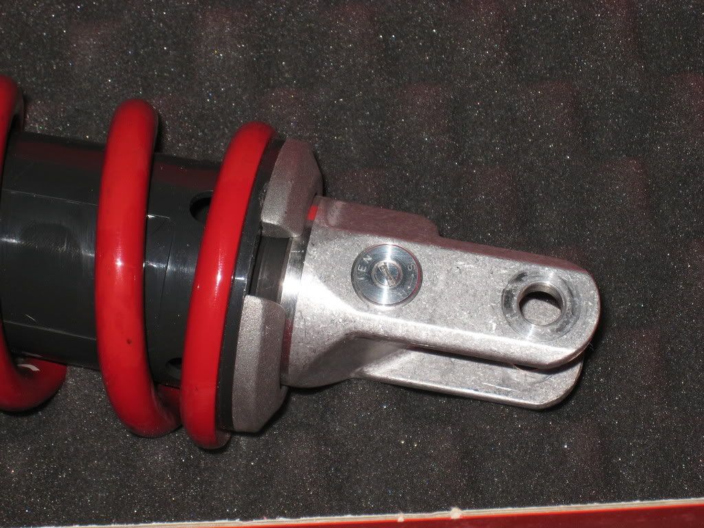

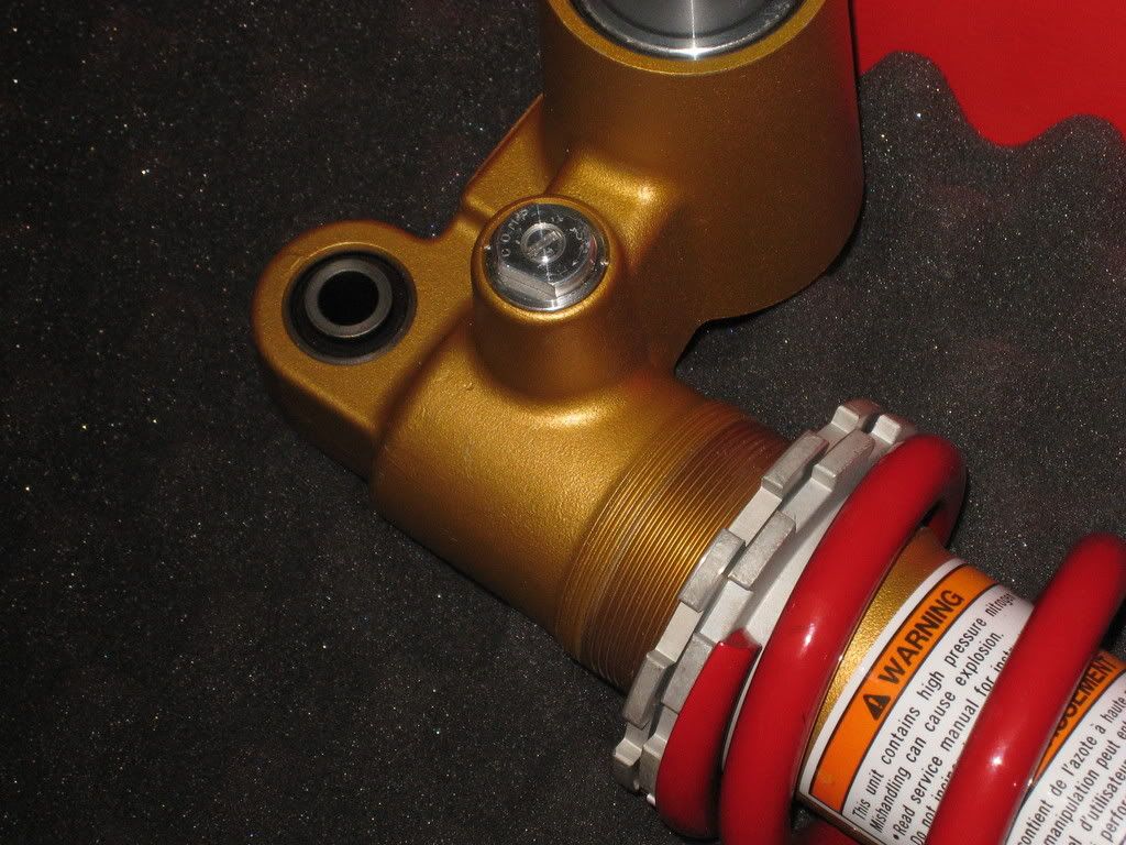

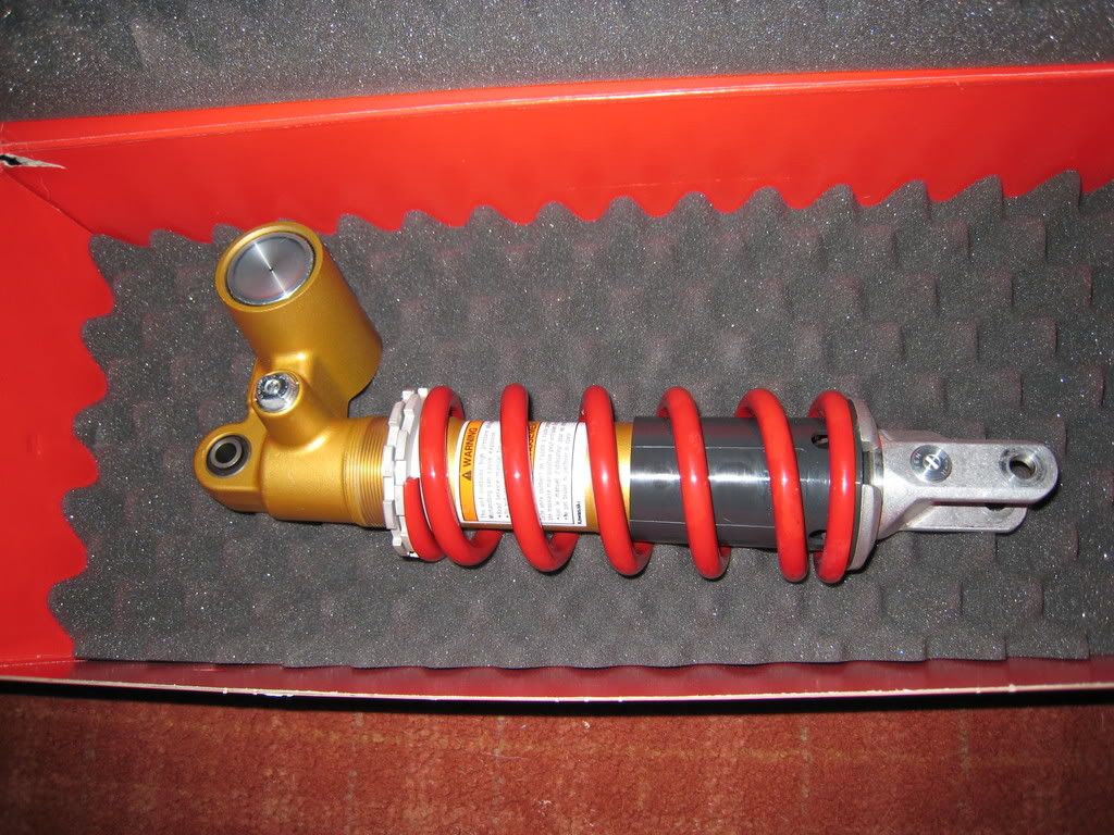

Hi sorry for this (stupid) question just got a zx10r shock through post but was wondering if some one could tell me which bit adjust the preload damping etc, Thanks Aaron

top adjuster marked 'comp' is compression damping. This adjusts the amount of damping on the unit while being compressed.
bottom adjuster marked 'ten' is rebound damping. This adjusts the amount of damping on the unit while extending (normally rebounding after a bump) .
The two stepped collars are used to adjust the spring pre-load. These are used to put a static load on the spring to set the amount of load it takes to start the spring compressing. Use this to set the sag at the rear.
That shock looks brand new! - congrats on your purchase.
