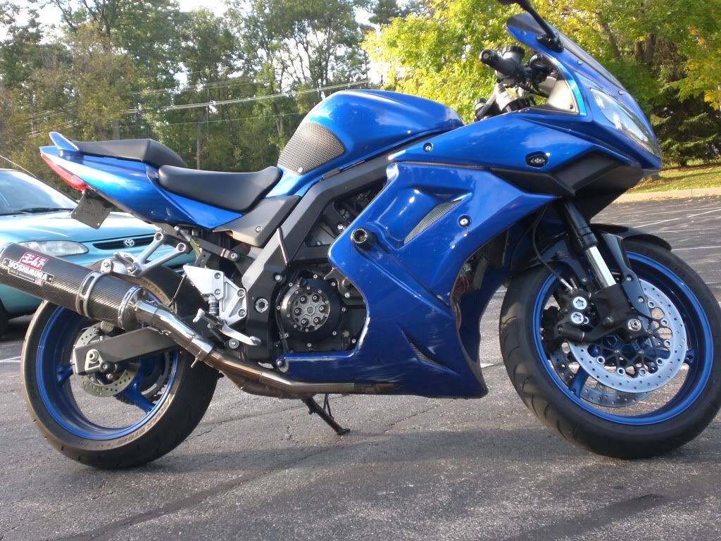

SVXR650
Default Re: GSXR Rear wheel on an SV?
This is my set up with a 190/50ZR17... I do prefer the 180/55R17 on my race tires...
When you buy the GSXR Kit, all the work you need to do, is remove your stock SV650 rear wheel and install any 06-09 GSXR 600 or GSXR750 rear wheel on...
You do NOT need to machine the wheel, you do NOT need bearings...
You use your SV650 axle, chain adjusters, same rear brake...
Some say slower turn in... But, have they used a 180/55R17? Or is it all just theory?
There is a reason why all 600cc to 848cc super sports have a 180 on the rear... Believe me, it is not for slower turn in...
Before you do wheel upgrades make sure you work on your suspension first...
Luis
PS: http://forums.sv650.org/showthread.php?t=143904

Old 21-12-09, 03:46 PM   #5
Stoneyginger
So it is possible
Old 21-12-09, 06:51 PM   #6
SVXR650
Yes!!! It is possible!!!
I have a more pictures... But I have not upload them yet...
Luis

It's pretty easy to do. A few measurements and a couple parts made/modded and put it back together.
