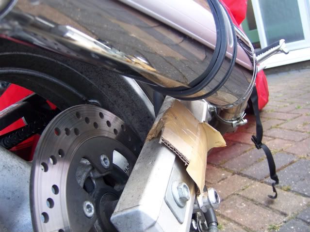

Just wondered if anyone had the same problem as me? I bought a 350mm Delkevic can for my 1999 sv but I'm having some problems. First of all they've only sent me one bracket for the link pipe (but that's apparently being sorted), and now I've noticed the main bracket that holds the can has been rubbing against the swingarm when the suspension is compressed.......leaving scratches (acting like a bumpstop).
From searching on svrider it seems that the Delkevic cans fit the pointy Sv's well but not the curvies with other people having similar problems.
Basically the link pipe is the wrong shape for my bike. They stated on the advert though that it was meant to fit all models. I've tried moving the link pipe about, but when it's on properly it leaves the can slanting in towards the wheel slightly leading to the scratches.
Do you think I have a case to get my money back? As much as I like the look of the exhaust I've had to resort to taping a piece of card on the swingarm to stop it being more scratched. I think now I would prefer a replacement, one that fits properly. What would you do?

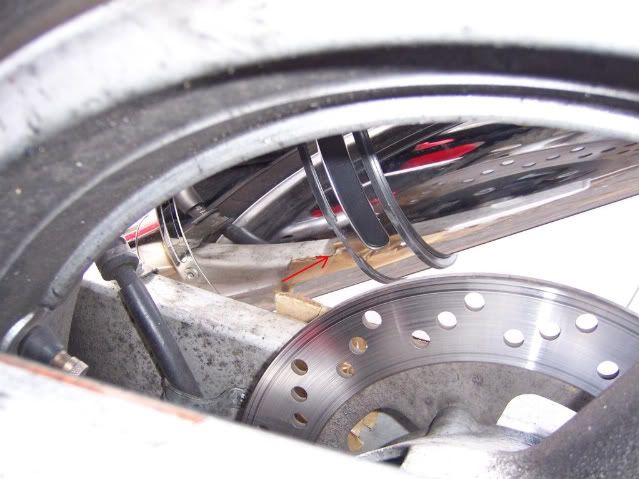

See the arrow below where the rubber on the bracket has been worn away....leaving scratches on the swingarm

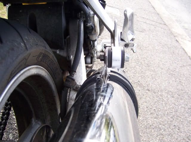

take/post a pic of where the zorst bolts to the hanger pls
Old 20-06-09, 06:08 PM   #6
Mr Farley
Default Re: Has anyone else had problems with Delkevic can hitting the swingarm?
You can see how the exhaust angles in from this picture....sort of

have you tried bolting the band to the ouside of the hanger?
Tried to, but because the exhaust is oval the bracket doesn't fit if you pull it across. There's not much play in the exhaust anyway....it's rock solid .
