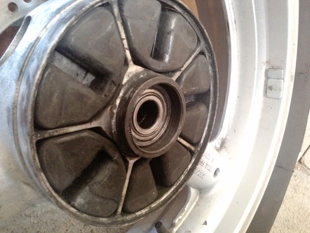

Old 19-05-10, 01:42 PM   #7
James SV
Default Re: sprocket carrier bearing
Is this ok? doesnt look right to me..
seems strange having the bearing so far in...?

Old 19-05-10, 02:51 PM   #9
Spanner Man
Join Date: May 2005
Location: Sunbury Middlesex
Posts: 1,396
Good afternoon.
That looks about right, providing you've got the central spacer in there all will be well.
