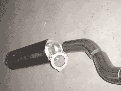

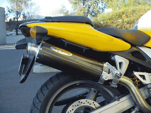

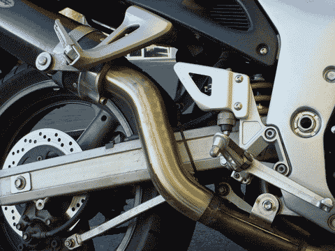

I made my own. Here are some pics of the parts and results...
The can was designed for a CBR 900, it's a Two Brothers Carbon Fibre oval, and is very short, and loud
The header pipes are made from 2 1/4" OD stainless mandrel bent 30 degree sections tig welded together, the adapter plate was cut from 1/4" SS plate.
I bought a rear header from a breaker which had already been cut for a slip-on, which means my original exhaust is still complete...

A man with useful skills!

Top fabrication on the link pipe Roger-looks like an excellent job.
