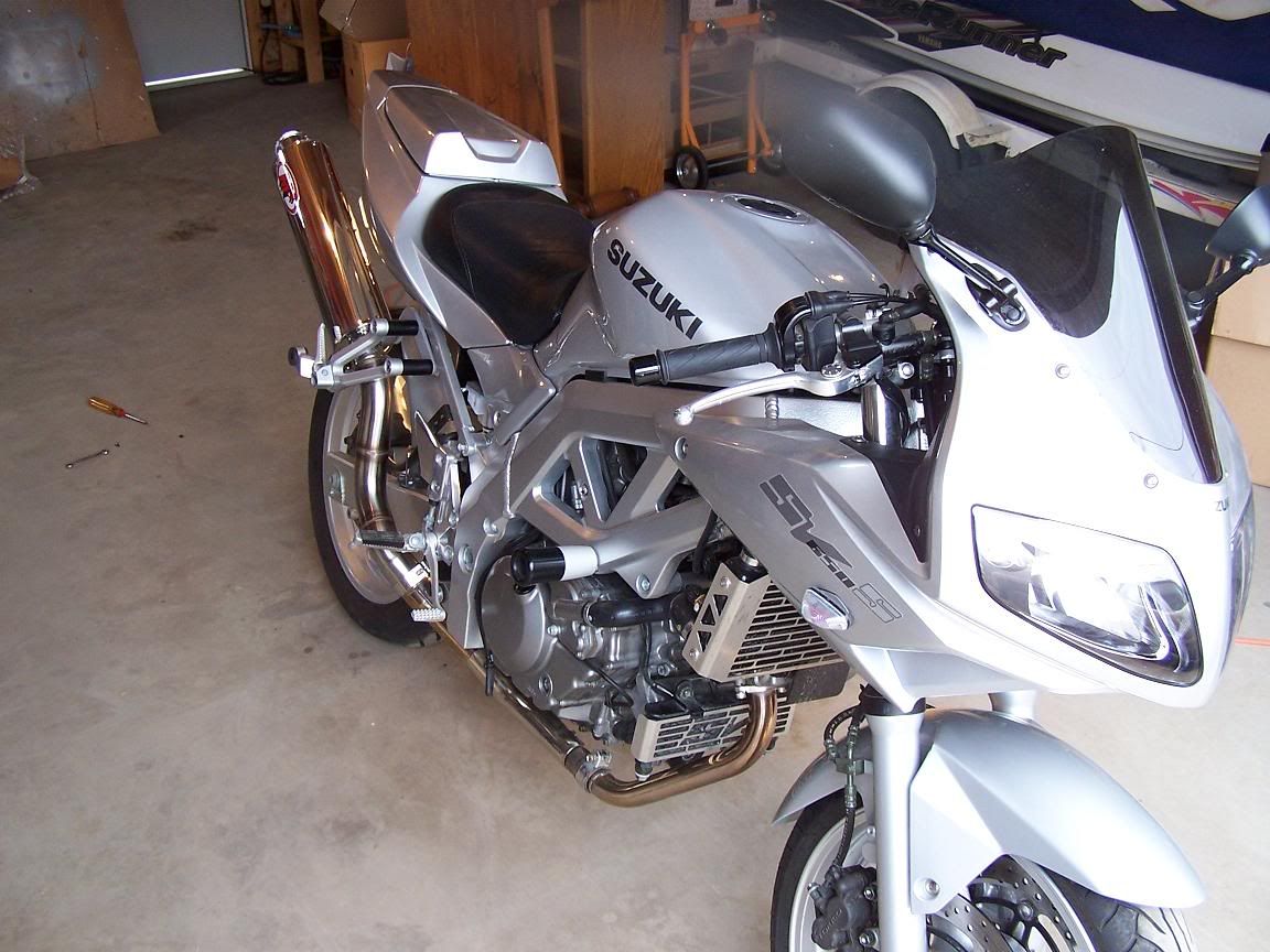

Hey,
The you can see the spacers on my highmount in the pictures below. Hope you get everything sorted out.
Thanks,
Mitch

Mervin
Here's a closeup of my curvy with the spacers.
Renegade supply them as part of their high level can kit. Their contact details are:
