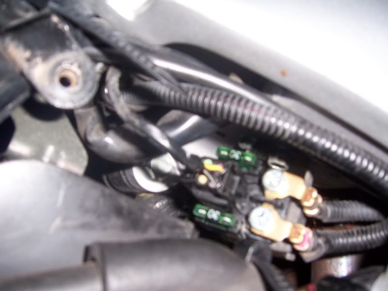

this is where it is coming from... ill post pics in a minute

both fuses are good ^^^

One of those fuses are a spare.

yeah i learned that today too...
That is the starter solenoid and a suspect from your symptoms.
Has it got water in it?
