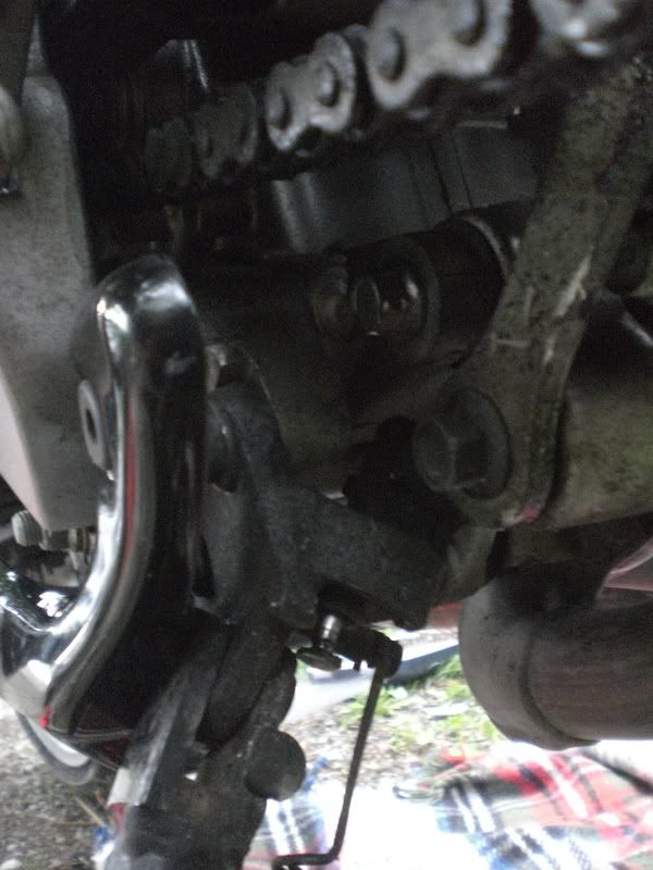

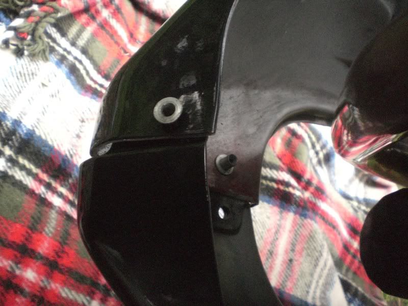

I am posting pictures of the areas where i am not 100% sure as to how to mount and install the fairings. the main reason i am having this difficulty is because along with the parts i was given a jumble of nuts and bolts etc.. most of which don't even belong to the fairings, so i am not sure whats what.
Im not sure how the two fairings mesh together, anyone have a picture?
just the the mount by the shifter, all others i figured out.
I appreciate the help!

I'm doing a service on Friday, so the lowers will have to come off. If you can wait till then, I can post some pics.

Right if i can remember
you have a bar looking thing. This mounts onto the front of the engine where the radiator lower mont is bolted to
You then have for brackets. 2 mount on the front engine mount bolts (Chrome infront of the main engine bolt)
Then one on one of the stand bolts and the other on the other side (I cant remember where exactly)
Hope this helps
Old 06-06-08, 10:00 PM   #7
simonthepost
Default Re: Fitting 99-02 oem lower fairings
bought my fairing lowers a little while back and am in the process of repairing them, came with fitting kit and instructions(THanks Colby !!) the fitting for the left side rear is the TOP no 8 allen bolt on the side stand, remove the bolt fit the fairing bracket (short one) then replace the original allen bolt, job done! if you want i could try and photoshop the fitting book for you?
