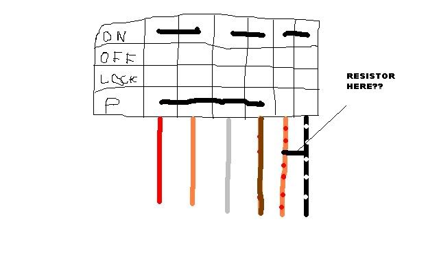

hi all i have a gsxr 750 srad with remote start.
just got a slight problem with it since i installed it the other day. everything works on it apart from the ignition side of things, i press ignition buttom on fob the bike ticks over but no power to lights and the bike doesnt start...could this be due to the fact that there could be a resistor in the ignition switch? if so how do i get by this?

i think this is how it might be done but not sure... if some one could give me a heads up then that would be great.
thanks

Well there is in the SV so I would have thought the GSXR is the same. Bear in mind that the resister is there to prevent someone from hot-wiring it[1] but yes your diagram is correct.

ok kl cheers druid.

yeah it is bypassed but still wont start in gear with stand down
Old 31-08-09, 02:34 PM   #10
sv650nutter149
Default Re: gsxr remote start
found out that the ecu needs 8-9vs to fire.... + line to switch is 12v but in switch is 100ohm resistor so when switch is on it reduces the 12v to 8 v using resistor... so if i put the resistor from the + line to the ecu line would this then power ecu to tell it to fire?
