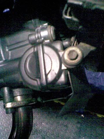

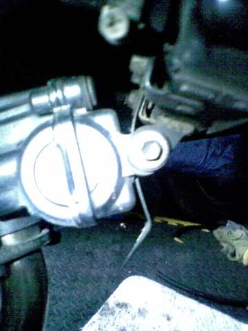

That'll do it. A bit more involved than the rubber flap I was thinking of. I reckon even if you stopped 50% of the water getting in it'd do the trick.
I'd have thought someone would have machined and sold something by now. Just something similar that attaches to the radiator mounting would do perfectly (not sure where exactly this one bolts to on a pointy).
I may have a play myself over the next couple of days with something very makeshift. A little worried it could cause other issues (perhaps overheating?) though. My messing with bikes usually causes unwanted side-effects

That looks v similar to what I saw many moons ago.
I think it was attached via the horn lug on the left hand side of the rad, but not entirely sure.
I dropped the rad off when I changed the plugs last and splurged silicone around where the boot sits against the head after fitting the boot - v heavy rain yesterday (dual-C down to 40) and didn't miss a beat

I've managed to find the old thread from '08 showing mods by our very won DizzyBlonde and a thread from svriders showing what some yanks did
Very interesting.
http://forums.sv650.org/archive/index.php/t-120017.html
http://forum.svrider.com/archive/index.php/t-27878.html
(highlights)
http://i23.photobucket.com/albums/b3...Vfrontplug.jpg
http://img.photobucket.com/albums/v482/Symptom1/fr.jpg
http://i205.photobucket.com/albums/b...11040019-1.jpg
http://i205.photobucket.com/albums/b.../cylguard2.jpg
http://i205.photobucket.com/albums/b...0/cylguard.jpg

Cheers. Bearing in mind the ease of machining something like that, why is nobody flogging bits of slightly bent metal with a screw-hole to do the job?
Surely it's going to be much more effective and doesn't make the front fender look mismatched.
