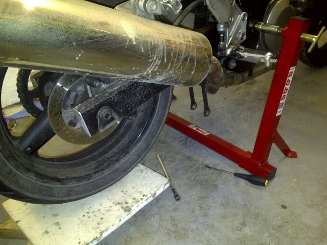

Get the bike on the Abba stand to take the weight off the shock:

Remember to support the back wheel - we had it on a block of wood and a piece of foam, which comes in handy later:

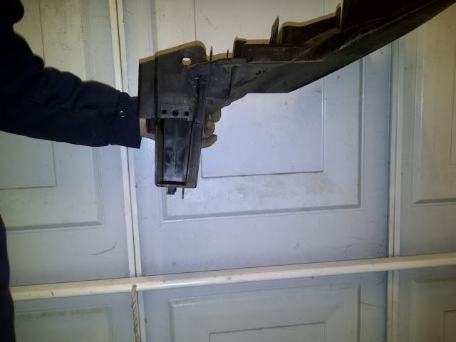

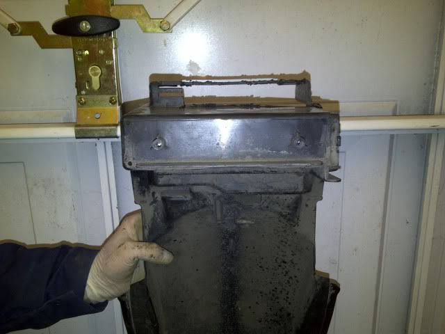

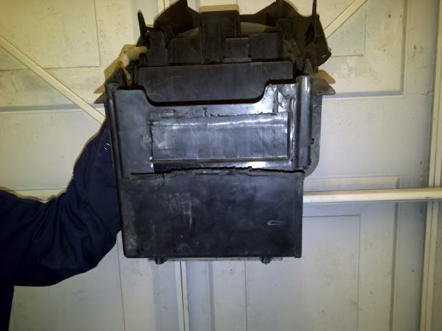

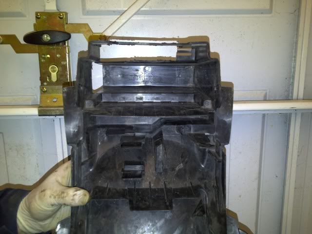

We then had to do the battery box cut. Despite reading the threads on this for the gixxer shock (on a pointy) and a kwak shock (on a curvy) with the pictures - mine seemed to look nothing like this. Perhaps because we were fitting a kwak shock to a pointy? I don't know. Anyway, we took some pictures of this from several angles.
From front on. We had to dremmel away quite a lot and if we could do it again, we would leave the plastic attached on the right hand side for rigidity:

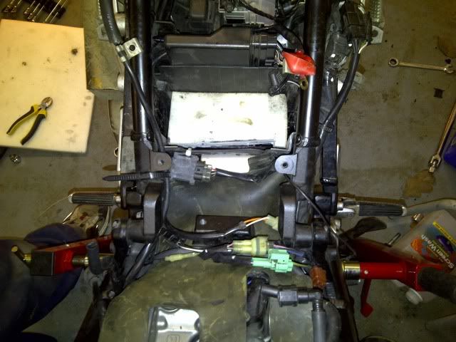

Now - from the front you can see that we have cut off all the mountings etc. A word of warning. We didn't know the the mounting on the left as you look at it as a rubber mount for the tilt sensor. So, we simply cable tied this back on the battery box roughly where it came from but didn't pull them tight. This resulted in us being able to start the bike on the Abba stand but NOT while it was on the side stand. It didn't take us long to diagnose the problem but it was a complete ball ache. To solve this, we used 3 cable ties to mount it level and tightly against the battery box.
From on top - so you can see how much of a lip the battery had to sit on:

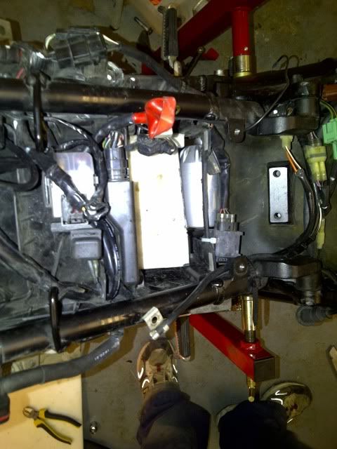

From the bottom - again to see what the battery is sitting on:
And for completeness the view from the left i.e. the side from which the tool kit goes in from. Just for information, the tool kit will still fit in there despite the new shock:

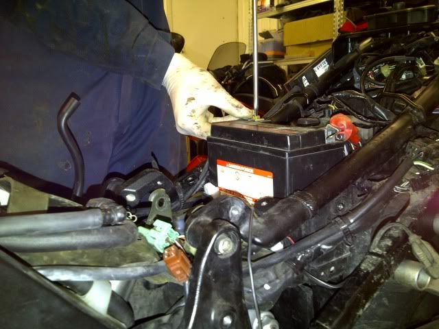

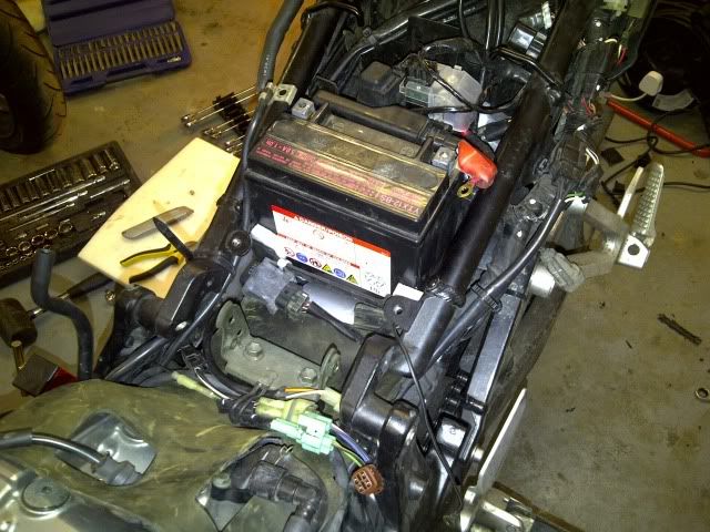

As you know, the battery now needs to be lifted clear of the new shock reservoir otherwise it will rub. For this, we used foam blocks. I don't know how thick the foam was etc but this is what it looked like and we had a few mm clearance:
And from another angle for some perception:
Then we had to get the battery back in. This isn't a problem, it now just sits very high in the bike:
The battery, once in, didn't sit quite straight and had a tendancy to fall forward. To stop this, we used a flat head screwdriver to wedge two pieces of foam either side to keep it up right. Note also the tilt sensor cable tied on the left with only 1 cable tie so it flapped around.

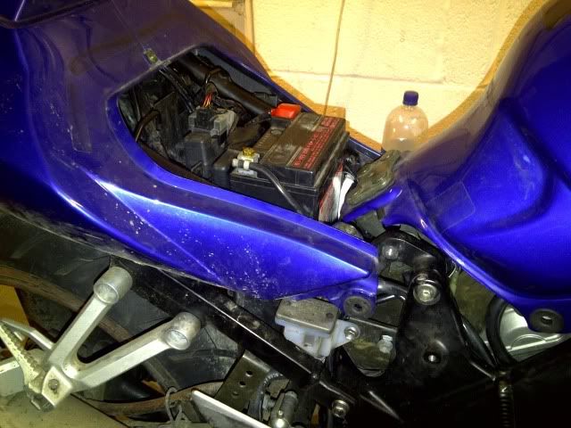

This is how it sat in the bike with fairing on:
We did have to trim that grey piece of foam under the main seat for it to go back on. We trimmed about half and it doesn't put a lot of pressure on the battery at all.
