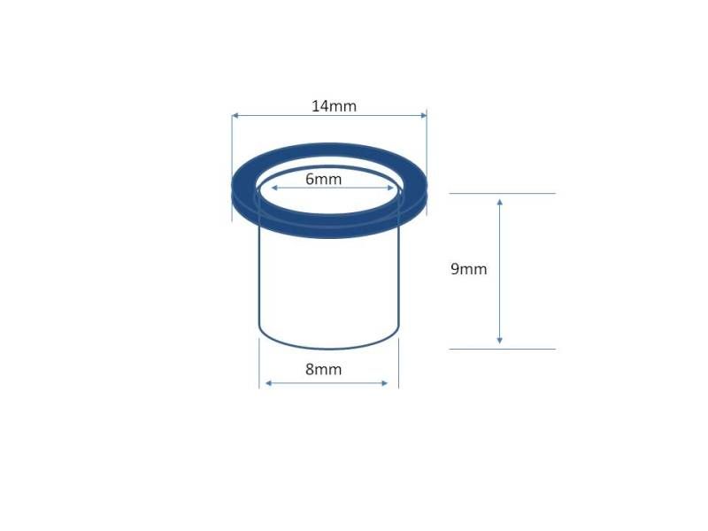

I want to know the size of the bushing with flange O (diameter, length)

Grommets for the small holes are => http://www.mossexpress.co.uk/mss/mss...y&search=10770
Grommets for the fairing spacer/crash bung holes are => http://www.mossexpress.co.uk/mss/mss...y&search=15104
With regards to the top hat bushes => they are 9mm high, internal diameter is 6mm, external diameter is 8mm, outside diameter (on the washer/top hat face) is 14mm and 1mm thick.
Hope this helps
With regards to the hole centres for the plate, they are roughly 40mm apart.

Thank you for the information but you gave me the measurements of small bush that manual says to be 14x8,5, to me is the measure of the bushing that goes in the only forum in which the two fairing (the lower fairing and upper fairing) overlap should be slightly larger than a bush and longer.
Can you give me the dimensions of the bracket to the hull gets near the sidestand? And as indicated by the yellow arrow in your picture!
