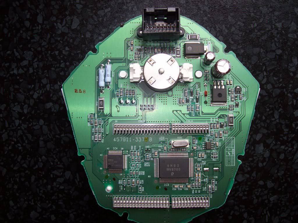

Now then just an update. Got it all into little bits . I'm no mechanic so just wondering if it all go back together! Have a look at these pictures.
It all seems fine to me, I'm wondering if it is the screen now because it looks like the spindle has melted from the top (ie the side next to the screen) and not the other way (from the speedo face). What do you guys think?

Thanks I now understand! Am I right in saying LED's don't get as hot as a bulb? Therefore making it even less likely it's the heat from the dash?

Somewhere on that thar PCB (printed circuit board) are some tiny little LEDs which light up your dash. They don't get very hot at all.
I was trying to be funny and clever in my previous post. Unfortunately I am neither!
Got to be the screen. I can't really think of a way around it other than covering the dash when you leave it on bright days. Or change the screen of course.
