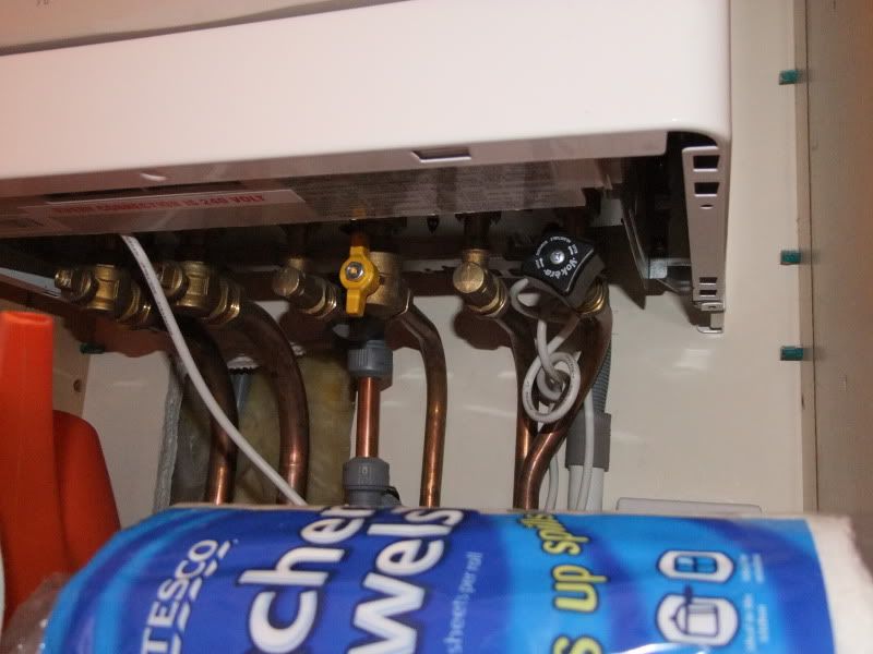

We've got an instant gas boiler. Recently when I've been using the shower the water doesn't get hot, it's just lukewarm. The only way to get it hot is to only open the tap very slightly so that the water is coming out slower.
And the kitchen tap keeps changing from hot to warm when it's being used
I was thinking it could maybe be something to do with the pressure sensor for the hot water? Is that adjustable?
Anyone know what the problem could be?
Some pics

Next to your central heating pump (I'm assuming you have heating, just not hot water?), there should be a 2/3 way valve, with a little lever on it. It'll be set to auto but move it to open and I think that should give you some hot water. These valves seem to last 5-7 years.

Unlikely to be a 3-port valve on a combi-boiler, which this one seems to be.
