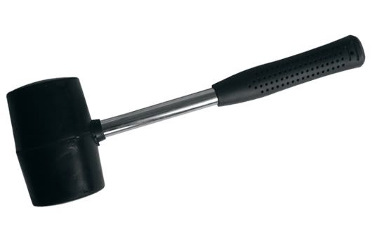

We just did the same with Squirrells brakes as they've been stood for so long.
Clamp in the vice and 'tease out' with a precision instrument
