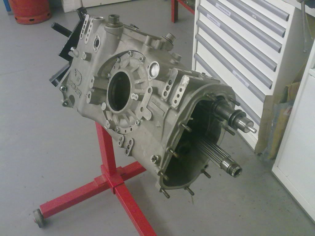

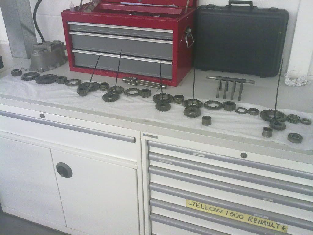

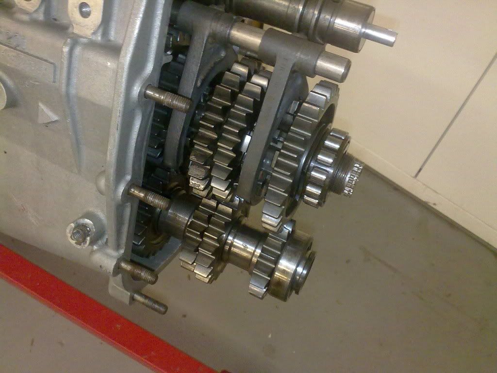

well to start with today i had to strip down a hewland sequential straight cut gear box as it was old and not needed any more (but spares are expensive so main parts are tagged and bagged)

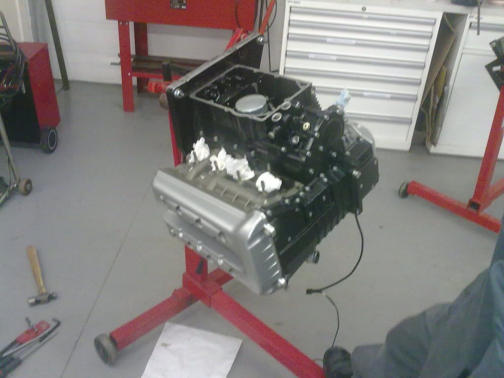

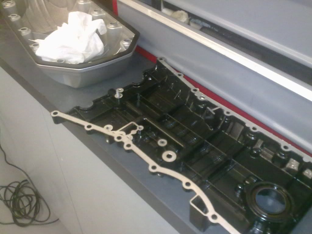

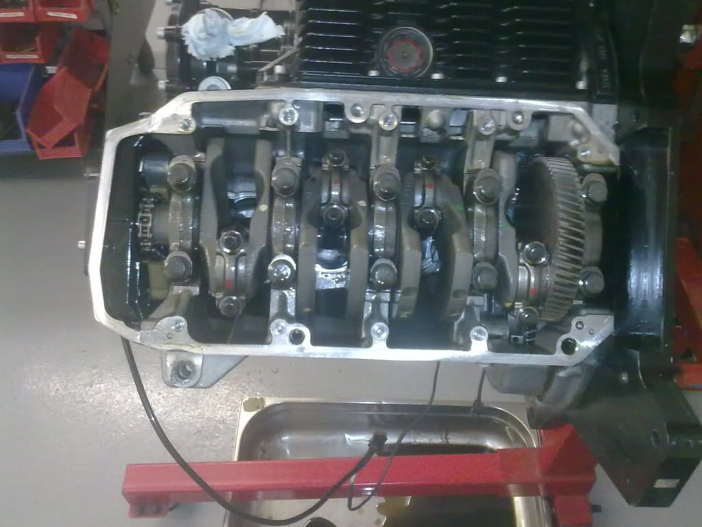

then me and on of the other lads had to carry one(of 7) k1200 bmw (these are bored and stroked to 1600cc) engine down 2 flights of stairs for the formula BMW race car and strip the sump down and reddy to be dressed tomorrow, there was a problem with a few bit as they were sliding parts that kept getting stuck so i polished them so hope fully the prob will be solved
Why would you stick the oil filter in the sump ? lol

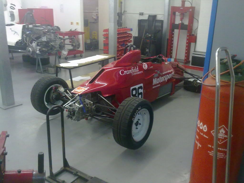

new(ish) forumla renault 1600 been built up again, we will be racing this

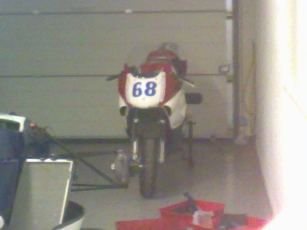

ss600 all lonley in the back of the shop, i need to helicoil the front disk mount and refit the flat slides at some point, its a race tuned cbr600 and just happens to be sprung for my weight

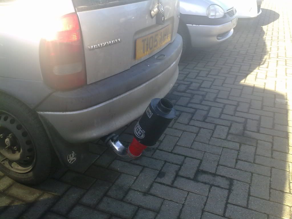

and this was the most important job of the day, fitting my mates air filter to my other mates car

Proper barryboy mod innit!
haha we started it up and it just fell off nothing unusual there

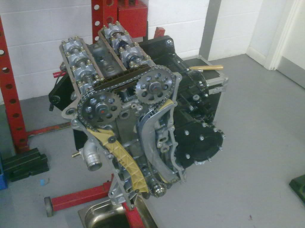

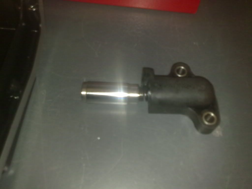

did some more fettling with the BMW engine (its really is cr*p lol) the oil pressure release valve was gets stuck the cam chain tension was getting stuck and making the chain skip, so polshed them up and all is good in the hood
the cam chain tension sits on the inside of the cam chain side cover so the only way you can get to it is to strip all the covers off (cam and crank) then take it apart ..
cam tansioner after a polish
this engine has got to be in the car by next monday ..... and we dont have half the parts for it yet
