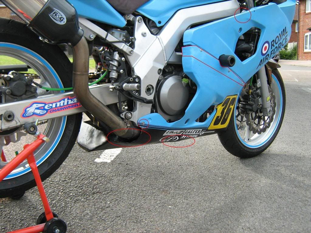

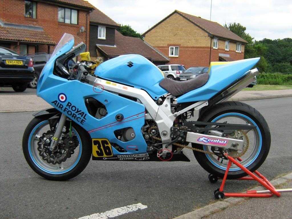

Hers is the rought bits I had to change. Oh and the top fairing is pretty much a perfect fit. Its the lower half that causes the problems.
All the bits in red are alterations by adding fiberglass and custom brackets.
This one shows the bulges I had to fabricate to all the downpipes enough clearance and for the exhaust to exit properly. You might also notice ive had to drill into the frame and tap a thread. I didnt quite get this side right where the two halves meet. As you can see they dont quite sit together properly.
